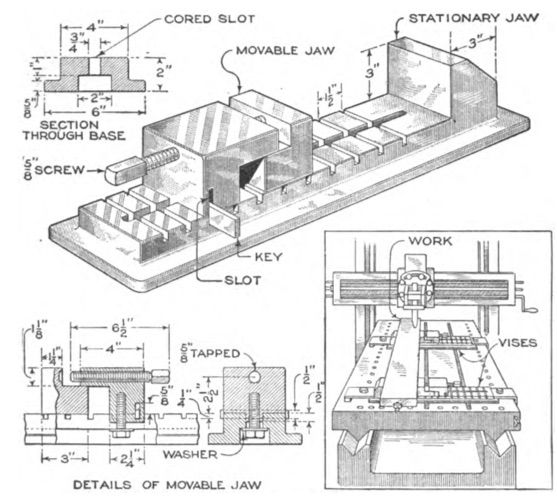

If you fancy making something for larger jobs consider adapting the jaw layout used on this planer vice to make a simple "endless vice" aligned along the Tee slots, rather than across the table as shown, to hold work direct to the table.
Forget the base and key. Scale down sizes as appropriate. Simply fix the jaws to the table with appropriate Tee nuts. Perhaps not as strong as the usual commercial and DIY versions, which are too big for your machine anyway, but much easier to make and adequate for smaller work. Its likely that a small cast iron angle plate could be found of appropriate size for the fixed jaw. Or just go crude and effective with a squared off block.
