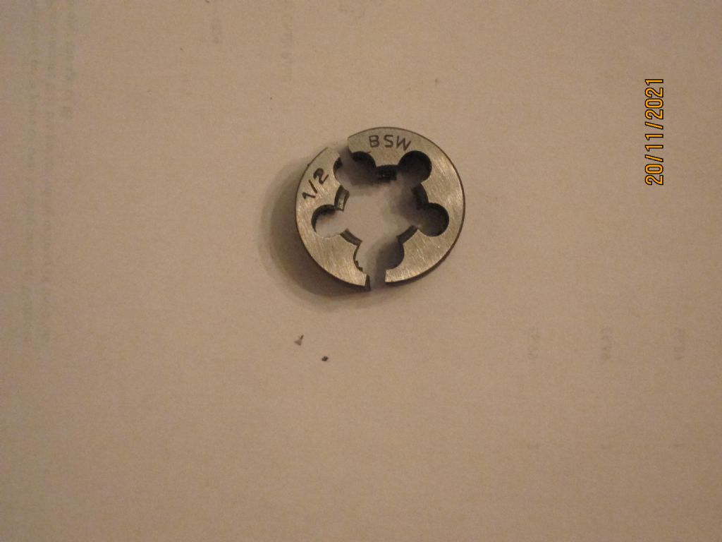

Hi - I have just suffered a breakage of a 1/2" BSW split die when adjusting the centre screw to back off the cut which on reflection I think was due to the fact that the die had been manufactured with a 1" O/D resulting in an inherently weak design. Surely a die of this size should have been made on the next size up in the O/D series e.g. 1 and 5/16" to give the necessary meat around the periphery. There is no evidence of the name of the manufacturer on the die and so have had to put the whole thing down to experience. Thought it might be of some interest and perhaps a warning to other users.

I have had the same thing with a 12mm metric in 1" od ! Just not enough meat to allow for the stress of adjusting. You lear by your mistakes, as I did, and use a larger OD ! Noel.

Perhaps the holder was too loose through wear and tear or not being made to a good tolerance originally. I have some that are not steel and look like they could break if pushed too hard.

Perhaps re-measure the die; I'm not doubting your die stock might be 1", but some of the imported dies are actually 25mm, and hence a loose unsupported fit in a 1" holder.

It's a trade-off:
the strength of the weak-section vs the force needed to open/close the die.
(Bit past the theory at my age but iirc the strength is proportional to area, the force needed is non-linear - cube-law seems to ring a bell)

Inclined to agree with peak4 that its a diestock issue. Some of the affordable ones are "less than precise". It was an inexpensive alloy one that did for mine. Bought in a 3 size set from a proper engineering tool shop too back in the mid 1970s so it wasn't a hopeless big box store or DIY house cheapy crappy. But with 20/20 hindsight and years of experience the fit isn't really good enough for large threads in small dies.
Identical die has worked fine in my tailstock die holder for many years. But the machined holder is a noticiably more precise fit. Probably doesn't hurt that the tailstock holder presents the die to the job in much better and more stable alignment than a hand die stock does. Coarse threads tend to rock as they cut the first thread due to the unbalanced load so you have to apply force to prevent that. Which probably isn't very kind to the die. Especially if its gone over a touch and needs pulling back on line.

I feel that putting a 1/2 Whit thread in a 1” die is pushing things a bit, it is a fairly coarse thread which will require a fair amount of torque applied to cut. A larger OD for the die will require a larger stock which will have longer handles and make the job easier. I wonder whether putting large threads in a small die means they should only really be used for cleaning up threads rather than cutting a thread from scratch. Dormer put a thread of that size in a 1 5/16” or 1 1/2” die, Tracy list a 1/2” Whit die in a 1”, 1 5/16” or 1 1/2” OD die. I think I would not go smaller than 1 5/16” as this is a much meatier item than the 1”, the dies also get thicker as the OD increases.

I'm also wondering whey the die needed opening up to back it out, either blunt or the two side screws were not tight when the thread was cut allowing it to spring and then be tight on the work.

Thats an interesting comment Jason. It would be interesting to ask if the die broke when adjusting or when backing off the job. If the side screws were not tight then any ingress of swarf when reversing the die from the job could exert far more pressure on the die than the adjusting screw.

I am afraid that I cannot offer any clarification on the circumstance under which the failed as the event took place some weeks/months ago and I only discovered the broken die wheh I came to re-use the die holder and the die fell out in two pieces! Have now ordered a replacement itwm having a 1 5/16" O/D which should prevent any further problems.

After decades of stationary engine restoration ,recently I decided to get a new set of whit taps and dies, only snag was the outside diameter of the dies,the 1/2 inch die was the similar in size to the broken one,so will only fit in a smalldieholder when a lot larger dieholder is required to as it requires a good force to thread 1/2 inch whit, so the small o/dia dies get used in tailstock die die holders, The set was not cheap and the first time I used one of the taps it shattered,this was replaced by the supplier. Stationary engines and steam work also require a good range of BSP taps and dies ,and I usually buy individually if I need a new die now I enquire first about the o/dia before purchase. I have had for a long time ,a WDept set of 1/2 to 1inch whit taps and dies English made of course,each die has its own sub holder which then fits into a very large die holder,this allows the dies to be adjusted to size and and the size is held by the sub holder.The tap wrench is a superb sliding block type in polished steel and still rust free, carbon steel which cuts as good as modern hss ,probably cost a lot of money even in 1939 .

Have suffered one or two broken dies, mainly due to overtighting the centre grubscrew to expand it.
But, 1/2 BSW in a 1" die leaves little metal to take the load.
With a thin wall like that, probably pays to treat it like a Tap and back off every half turn, to break the swarf.
