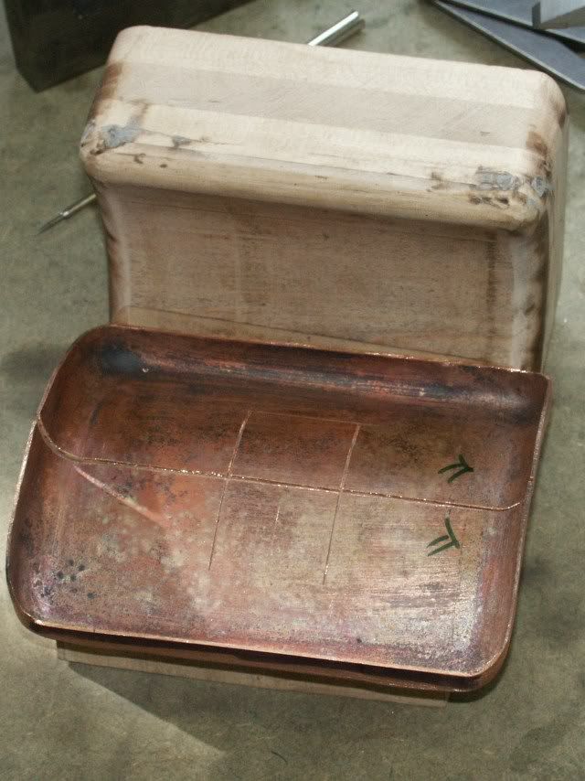

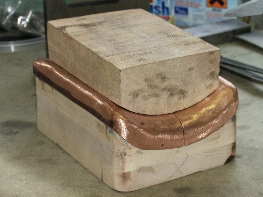

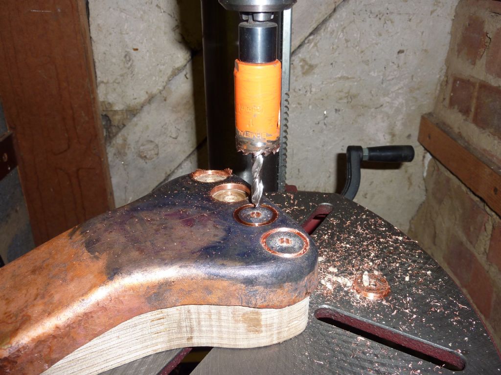

Dave Smith 1427/10/2021 11:04:12
222 forum posts
48 photos
I used plywood for the flanging on my Aspinall and 3D printed formers for outer and inner wrappers, which work a treat. I have also used a 3D printed former successfully to reshape one part when I got plywood shape wrong.
Hope the following photos may be of interest to some people.
First couple of photos show the 3D formers.
This photo shows the laser cut and 3D printed drill jig I made to get all the bits in the right place.
