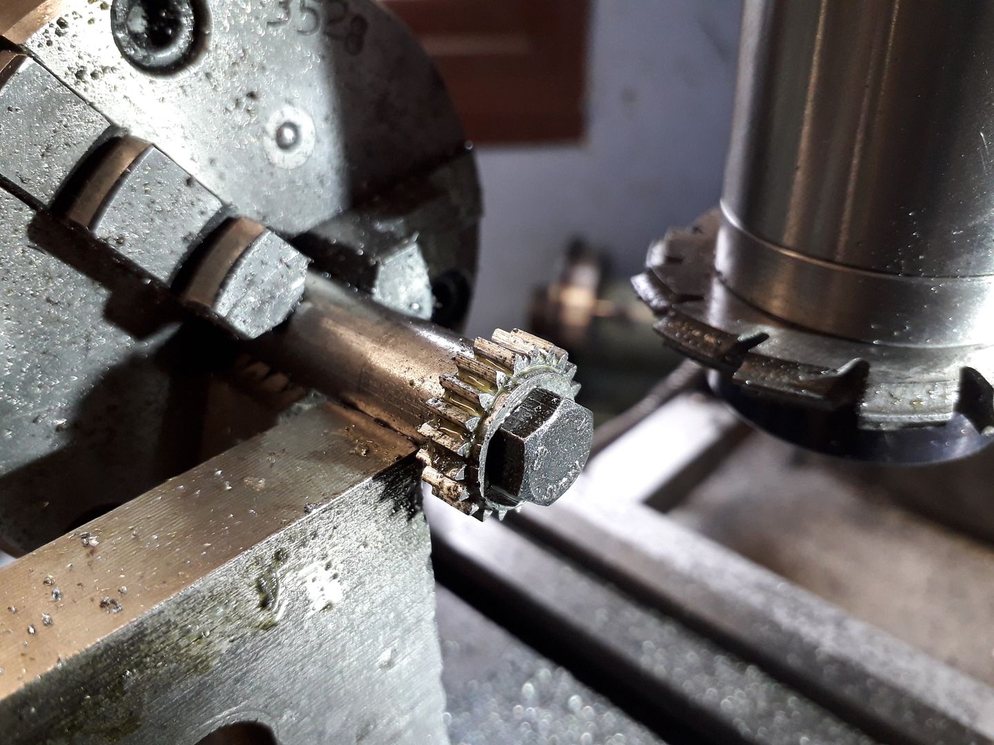

I think I may know the answer to this, but would like to check before trashing any more brass.
I want to make a number of hubs like this:
That's a mess I know, but it was a proof of principle exercise, not intended to look pretty!
I set up the 'proper job' to cut the 3/16" slots like this:
The brass disc is held against the steel stub in the chuck by two sided adhesive tape and tailstock pressure. The work moved with consequent knackerment.
There's no reason why I couldn't drill the disc through centrally to take an expanding mandrel, but I haven't got one and it would cost me 50 quid to buy. I think that if I just drill the disc and turn a close fitting mandrel with a shoulder and threaded end to allow me to clamp it down on the shoulder with a nut and washer, dispensing with tailstock  support. it should work. But I'd like a sanity check before trashing any more (expensive) brass!

For a cheap and cheerful expanding mandrel,
Turn a bar to size,
Drill and tap the hole, but only use a 1st/taper tap
Slot the nascent mandrel,
Wind in a grub screw.
Because the tapped hole is tapered, the grub screw will expand it.
Bill

Does it even need to be an expanding one, just turn a short tight fitting spigot on the end of a bar and then tap for a cap head screw. Add a washer and fix blank to arbor, I've cut gears that way without problems.
If you want to use tailstock support then just include a smaller dia spigot that can be threaded and use a nut.

Thanks for replies. This is what the slot looked like after the first pass (2mm DOC):
It seems that the work wandered clockwise:
I was cutting away 'front to back' in this view with a 2-flute slot drill - so conventional milling on the left hand side of the slot. I guess that makes sense - the bit was trying to pull into the work.
The reason that I tried this setup was that I'd used a similar arrangement for turning and facing on the lathe and that works well. Presumably that's because a it doesn't matter if the work slips a little around the rotational axis when the the cutting force is applied. A different result when milling though!
From replies it looks that I don't need to buy or make an expanding mandrel, which is good news. The 'bolt on' approach should work. I can make a through hole, as I said in my original post.
With the benefit of hindsight I should have done the milling before the turning/parting as suggested, It's not the first time I've painted myself into a corner and had to devise an escape route blush.
Robin.
