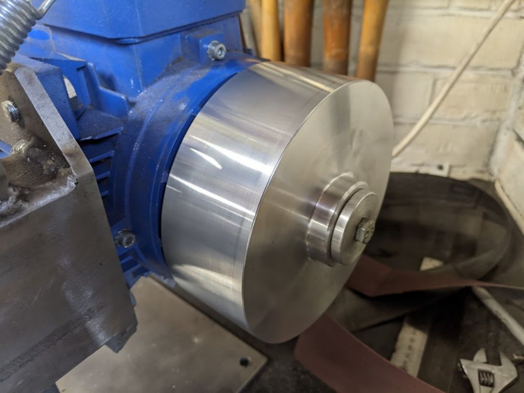

Hello all, I could do with some help
I have a wheel from a belt sander I've been rebuilding, however, the wheels bore is too large and not concentric with the outside surface so I get about 10 thou runout at best after I've shimmed it. Not great when it's spinning very fast.
Video of runout
I'd like to bore the center out, then plug it and rebore it properly so everything is concentric.
I have a slug of around 40mm aluminium just the right size to do so, but before I jump in and start making chips I just want to ask about the fit. The motor shaft is 24mm so the hole will be reamed to that at the end.
I've looked in the zeus book about what to do, but having never done it before I could do with a second, third or more opinions.
If I want the plug to press in and never come out again, what sort of dimensions should I aim for?
Would it be better to drill out the majority of the center of the plug as well?
Will the center being removed after effect the fit?
Thanks

Just to get the ball rolling, in this situation Loctite is your friend.
Tony
old mart15/08/2021 20:26:40
4655 forum posts
304 photos
I agree, make the joint with 0.001 clearance degrease both halves and use Loctite 601, 638, 620 or the equivalent. Leave the joint 24 hours and you are good to go. If you ever need to disassemble the joint, heat the assembly to 300C to destroy the Loctite. A turned finish, not polished will give the best strength of joint.

You may also want to bore the plug to fit rather than ream, the average reamer is usually H7 or H8 which is a plus size which may be OK for a running fit like a bearing but could be a little loose for your pully.

Not sure I explained clearly. The final motor shaft hole will be reamed, but the hole for the plug will be bored. So the running fit will be fine for me.
I'd like to stay away from loctite and try to do an interference fit. I think it'll be more challenging to get things to the right size, then if I mess it up I can do loctite, although I currently only have loctite 271 which is thread locking.

The wheel was initially machined by a technician at the college I went to. I'm not even sure the college had a boring bar at the time so I think he just drilled it. The outside was turned on a mandrel but I believe the mandrel was not a tight fit in the hole, so the outside wasn't turned correctly. It really is just the center hole being oversized that has caused issues.
The bolt on the centerline holds the wheel on the shaft. I'm sure a setscrew would be better, but I don't think I have the right set up to try and do that.
The taper lock bush is also a good idea. It looks like the standard ones for 24mm motor shafts have a dia of 57mm so that could be a third option if the other two fail. Once again I don't have access to a milling machine so drilling the half holes may be troublesome.
