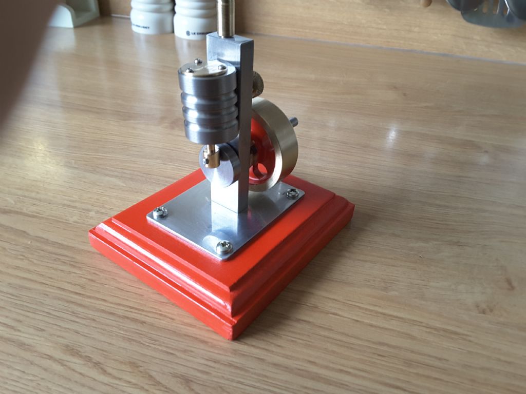

I went with the Muncaster Simple Oscillating Engine for my first attempt, I just thought it a nice looking engine for a simple one.
I used the Julius de Waal drawing which is available free on line and with dome guidance from Jason it turned out well. I learnt quite a bit on both the mill and lathe in making it. I did change some of the material on some parts and went with a cast flywheel which I thought looked better than the machined one on the drawing.
Pic below

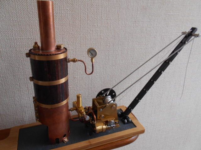

dscn1185.jpgI found this book at a charity shop, four easy engines and boilers to run them. If you need a drawing let me know. BUILDING SIMPLE MODEL STEAM ENGINES, By Tubal Cain. This is the crane, most difficult of the the four.
Bob

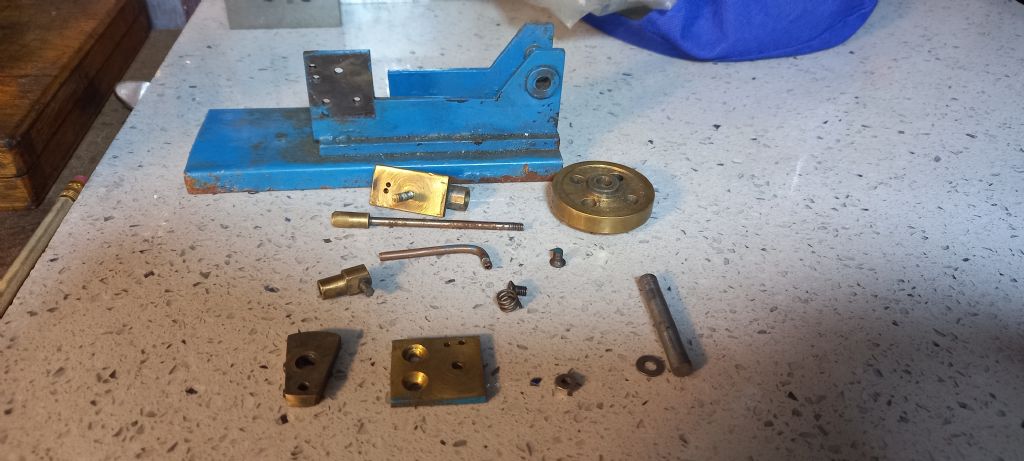

20210709_165235.jpgHello Matthew,
This wobbler has been sitting in a box, I can't be bothered to refurbish it, looking at it a few parts to be made and it should work OK. A good start if your thinking of making one, you can have it just PM me.
Bob
