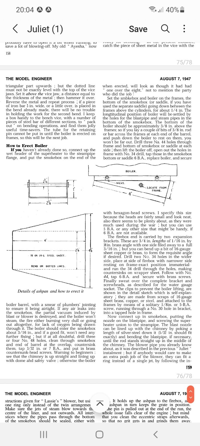

Hi Pete,
Attached is photo of Juliet article from ME with dims of the ash pan.

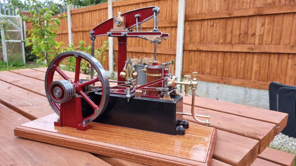

Here is my beam in humbrol no.20 crimson gloss.

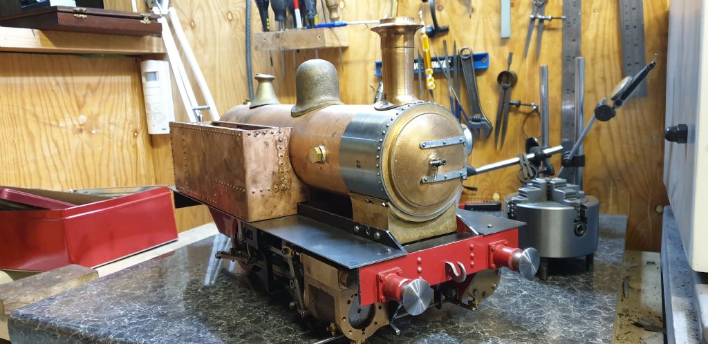

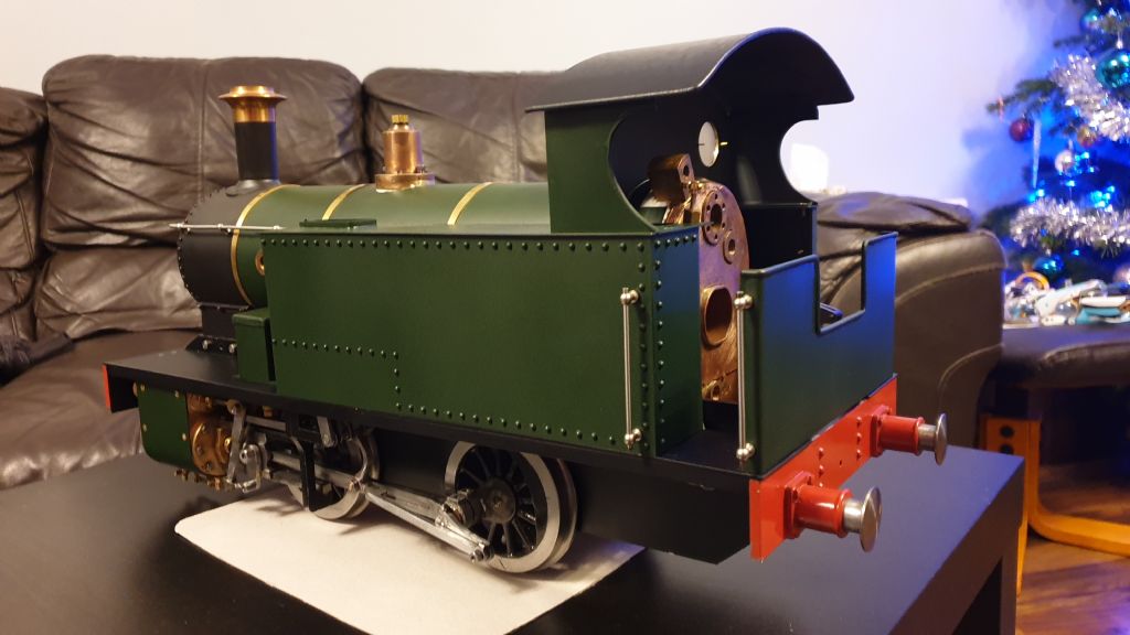

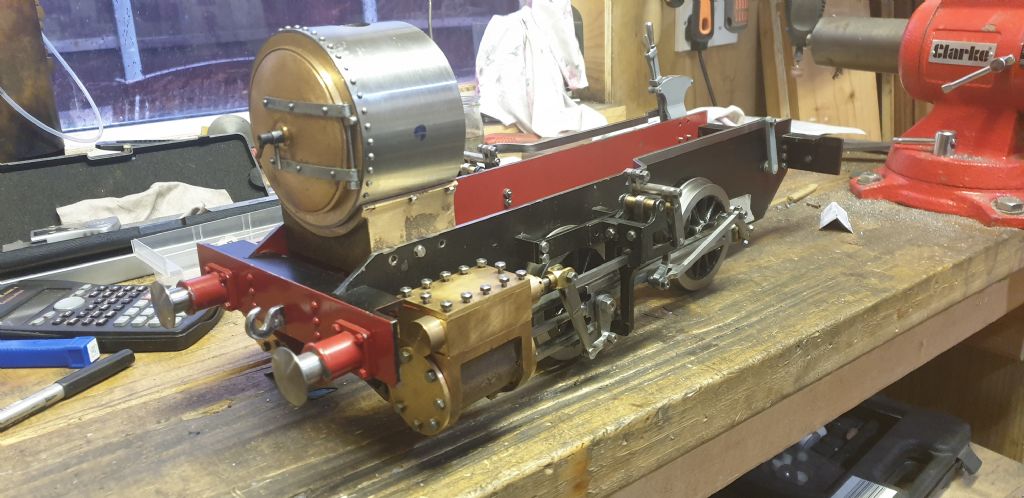

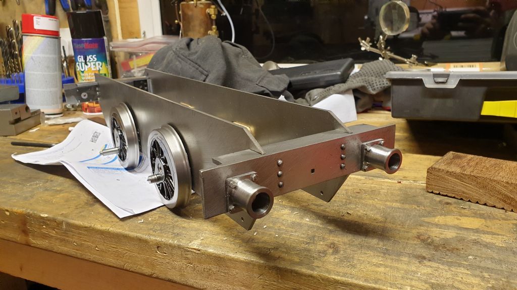

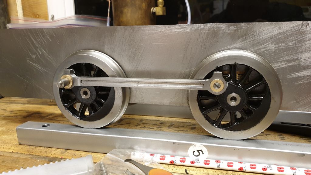

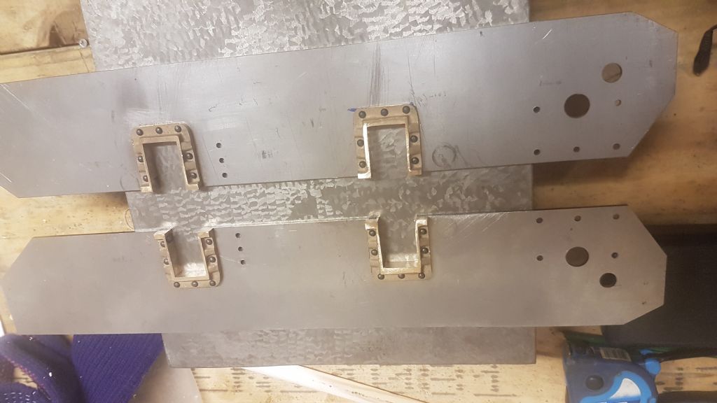

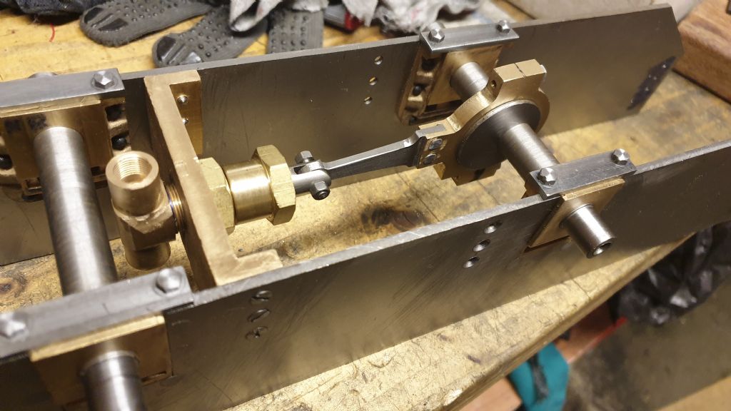

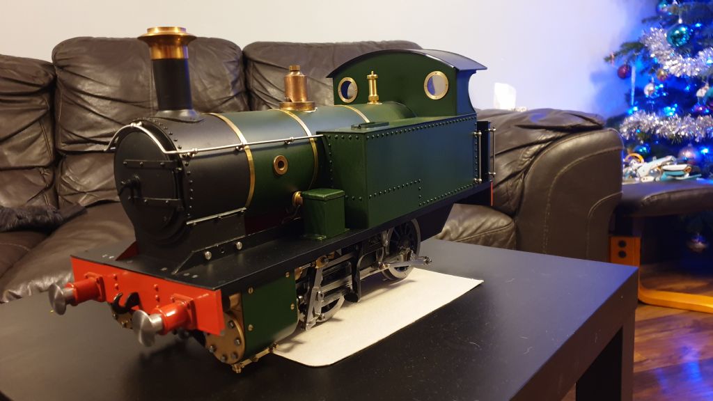

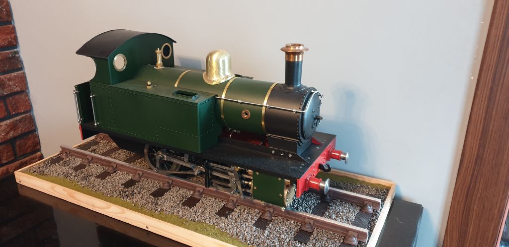

Hi all. Here's some photos of my Juliet started in 2019. It was start and stop build disturbed by other projects, house improvements, covid etc. Still far from finish, but now it's on the stage where I can proudly display it in our living room
Any comments are welcome.
Stay safe!20190121_190711.jpg20190806_182007.jpg20191128_202827.jpg20200206_193334.jpg20191121_201604.jpg20191211_194903.jpg20200510_150257.jpg20201008_195504.jpg20201104_170933.jpg20201213_172020.jpg20201213_172054.jpg20210109_153044.jpg
