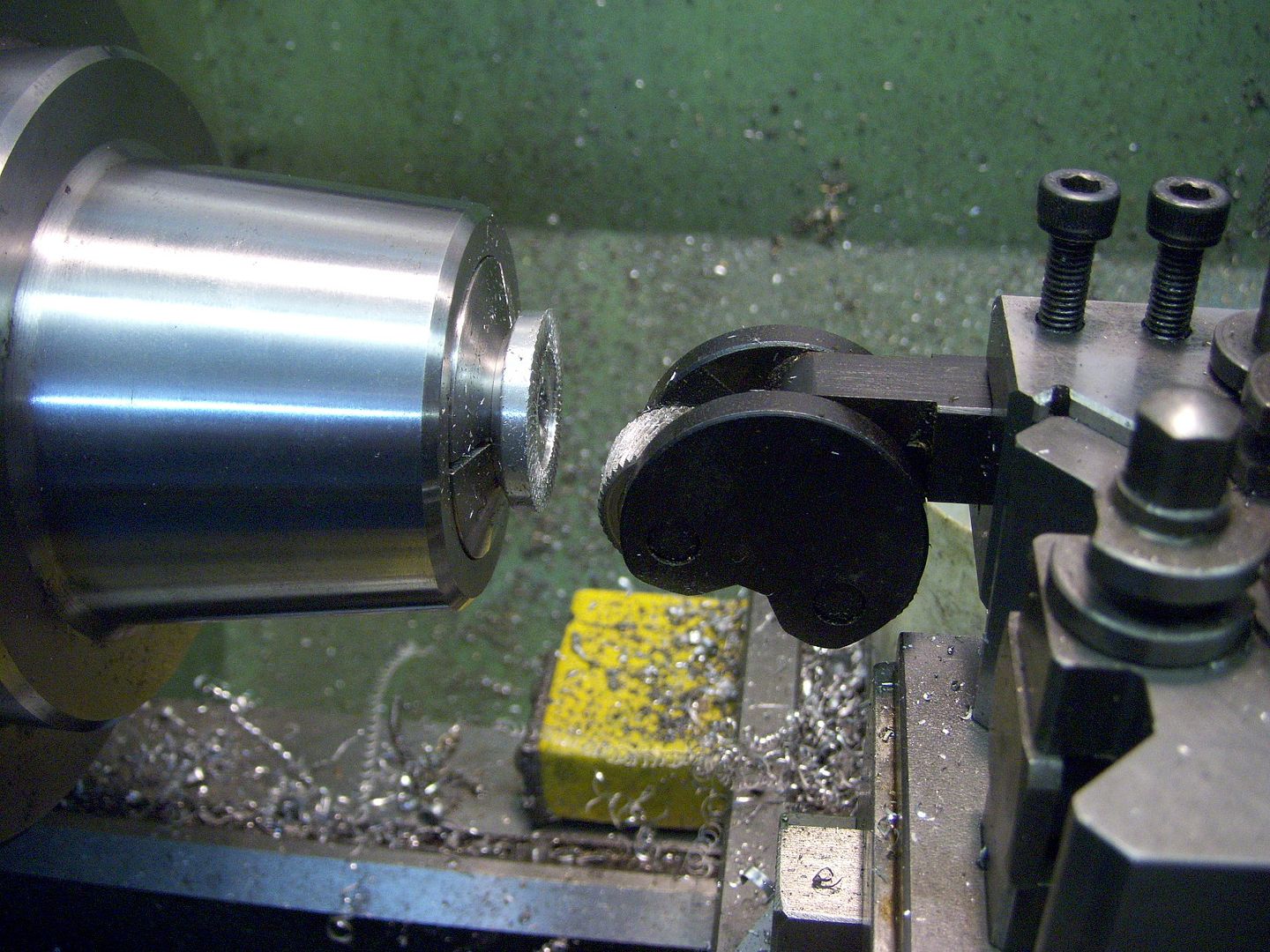

I was toying with the idea of making some deep fit acorn style cycle/motorcycle wheel nuts as I cant find a supplier for 3/8 bsc 26tpi x 20mm deep.
I thought it might be a simple project however with commercial wheel nuts they often have a serrated edge to retain on the fork. I know I could use crown washers or some similar option however how would I go about knurling or serrating the face of the nuts?

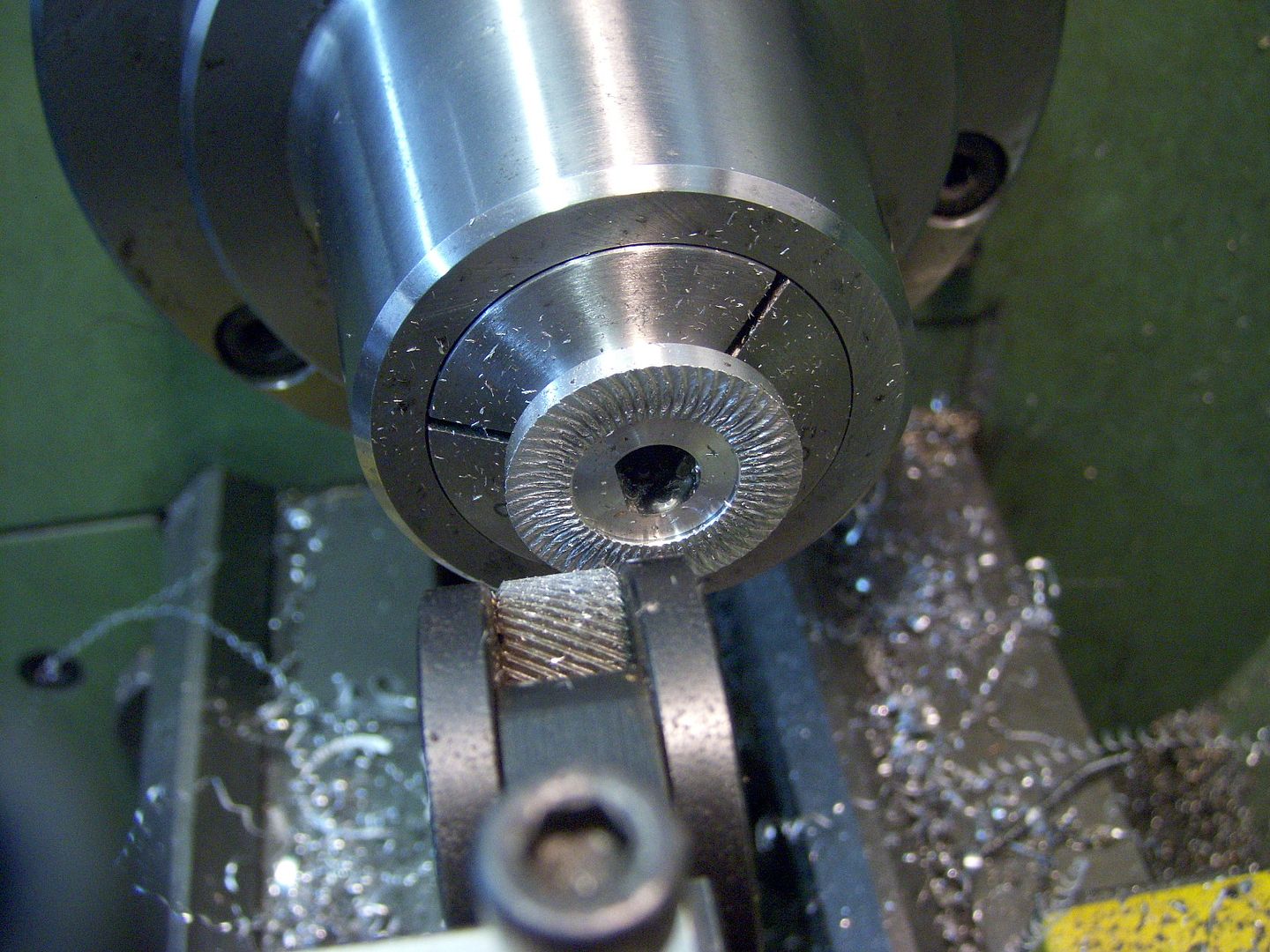

Take a bog standard knurling tool and set the height either much lower or higher than usual, flip the end up/down so only one wheel is engaged and feed into the slowly rotating face.
Alternative is to set up in the mill and cut two sets of Vee Grooves at 90deg to each other into the face.

Jason I'm curious how you machined the hole in that part with the flat

I've not tried it on stainless but would think it would need a lot of pressure applied to it.
Hole forming here
