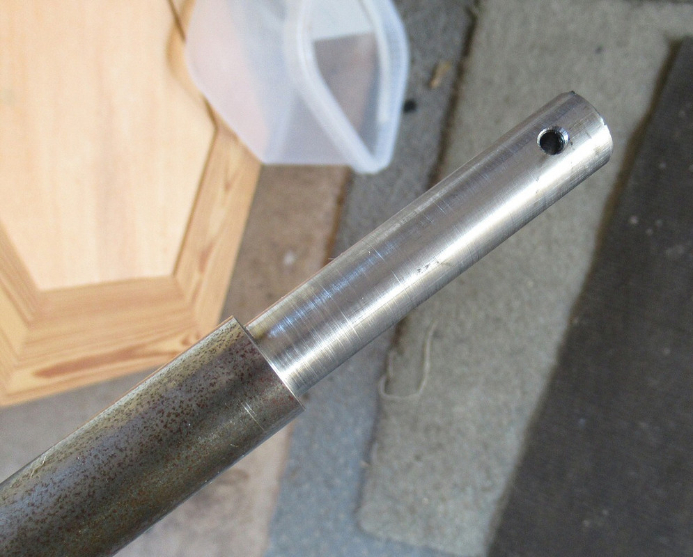

Justin Thyme | 15/06/2023 18:12:12 |
72 forum posts | Just reviving this old thread. First real go at using the lathe (at least first time making something for purpose) And was a bit disappoint at the smoke it was creating, seems pretty obvious it would be unwise to be breathing this stuff in, although I did today. I was cutting back 70mm from the end of a bit of 20mm dia bright steel bar to 15mm. I was told to apply a dab of cutting oil to the surface before each cut. It was fair smoking, The cutting could be described a bluish spirals. I may be should have worn my forced ventilation ffp2 helmet that I use for wood tuning, (not sure if ffp2 is useful against smoke?) Creating ventilation could be a problem (unless I start using it a lot) However I read this thread with great interest - as I was using a carbide cutter (or at least I think I was, brass coloured diamond shpaed bit), may be I need not have used any cutting oil (or may be just some for the final cut) So to my question - Is it fairly agreed that not using any cutting oil is OK when using a carbide or tungstan Carbide bit on mild steel ? and here it is (a new axle for a sack barrow) quite proud of it.

![]() 1766 forum posts 46 photos | Hi Justin, As I said in my 2021 post, when using carbide tipped tools I usually don't use any cutting oil for the roughing cuts. I do use oil for a light finishing cut as it seems to improve the surface finish. Thor |
Andrew Johnston | 15/06/2023 19:52:07 |
![]() 7061 forum posts 719 photos | There is soluble cutting oil, based on water, which is primarily for cooling with a little lubrication. And there is neat cutting oil which is primarily for lubrication on high pressure cutting operations with a little coolant. Applyin a dab of either before cutting is a waste of time. All it will do, with cutting oil, is produce smoke. With carbide lathe tooling I always cut dry, except when parting off. I use soluble oil on the lathe and run flood coolant if I need it, mostly with HSS tooling. The part shown will be fine as sackbarrow axle, but the finish isn't particularly good. What is the provenance of the steel and the carbide insert? What speeds, feeds and depth of cut were being used? Andrew |

7517 forum posts 20 photos | Posted by Andrew Johnston on 15/06/2023 19:52:07:
There is soluble cutting oil, based on water, which is primarily for cooling with a little lubrication. And there is neat cutting oil which is primarily for lubrication on high pressure cutting operations with a little coolant. Applyin a dab of either before cutting is a waste of time. All it will do, with cutting oil, is produce smoke. With carbide lathe tooling I always cut dry, except when parting off. I use soluble oil on the lathe and run flood coolant if I need it, mostly with HSS tooling. The part shown will be fine as sackbarrow axle, but the finish isn't particularly good. What is the provenance of the steel and the carbide insert? What speeds, feeds and depth of cut were being used? Andrew As well as whether tailstock support was used. Guessing it was as it should have been. Not important, but did you check for taper? It looks like that finishing cut was of too little depth for the cutter? |
