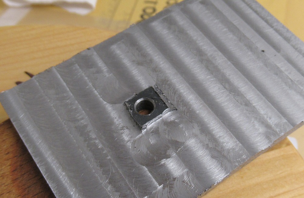

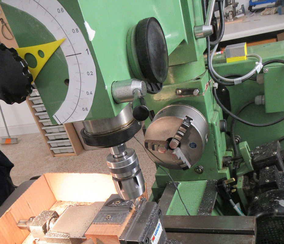

20/09/2023 11:05:52
Posted by JasonB on 20/09/2023 10:09:59:
0.2mm is a bit shallow and will tend to just wear the very corners of the cutter, What was the total depth you wanted to remove?
it is a wedge shape, so 0.5 off one end and 2.5 off the other. at 0.2mm it seems to cut with consummate ease. at 0.3mm there seemed to be a bit of viabration, it all seemed a little less happy.
20/09/2023 10:07:48
What about depth of cut? I used 0.2mm for each pass, is this about right?
And on the subject of depth, this machine does not seem to give any real means of adjust depth accurately - hence the print out and dial that I have stuck on the end
20/09/2023 09:19:50
I think it is a tungstan carbide cutter, but will check    (how would I know, I don't see how all those flutes could be?)
Yes the quill is locked. but I was not locking the x axis hen moving the Y. would that make a difference ?
not sure waht you mean about ridges between the lines - it is mainly visual, although I can feel a roughness with my fingernail.
Edited By Justin Thyme on 20/09/2023 09:36:41
20/09/2023 08:55:37
Could anyone offer some advice on how to improve the finish, it isn't too rough, you couldn't peel tatties with it but I would have hoped for a better finish (i still thing it will polish up ok with some wet and dry)
speed 2000 rpm, 10mm 4 flute, used cutting oil.

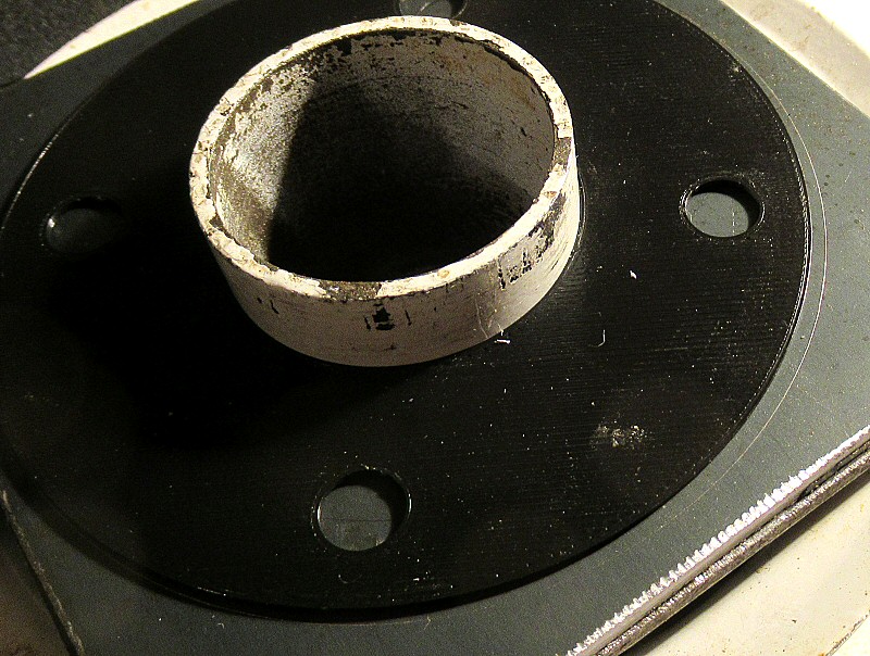

19/06/2023 21:15:25
Posted by Nick Wheeler on 18/06/2023 13:31:23:
Were the four bolt holes in the original request?
Because they change how you make the part:
Start with a piece of stock big enough to create the piece
Mark the centre of all three(centre hole, outside edge and PCD) circles.
Draw the centre and outside edges with dividers.
Mark out the PCD.
Drill the PCD

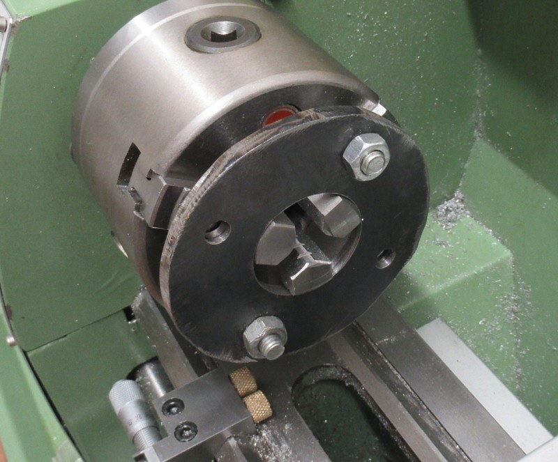

Bolt the piece to a (sacrificial)faceplate using the PCD, and ensure it runs true to the centre mark
Machine the inner and outer edges.
You make several pieces by bolting them to the faceplate at the same time
Ooop's, yes I seem to have omitted that important spec..
I did mark out all the three circles before I started. The problem arose when I used the pillar drill to bore the centre hole out with the hole saw, the pillar drill is so unconcentric it managed to get the not very round hole in the wrong place. See my first image, you can see the scored line .
Never mind, I managed to mount it on the milling machine, and with an edge finder on the inside of the hole I worked out where the centre would be. from here it was very straight forward to get the holes drilled accurately (within a few thou, I quite surprised myself)
I was then able to score a line to where the outer edge will be. From there I have hacksawed and angle grinded it down to a roundish shape.
I'm going to have a good think about how I will lathe this down to its 89mm dia - it's non-roundness is a concern. What speed should I start with? When doing such things turning wood I will keep the speed very low until it gets fairly round. Will I use the same tactic on steel ?
I did spin it and felt 100-150 rpm seemed OK, not sure though
I could get a 3rd bolt in to hold the plated together, should I bother, it seems very secure

I now have the two squarish plates with a 39mm hole in the middle. I now need to create an outer edge of 89mm dia concentric to the inner hole, and also 4 evenly spaced 8mm holes 35mm from the center.as per this 3d printed one
The plan is to mount it into the chuck as per JasonB's earlier picture
My plan is to then score two circular marks, one with a dia of 70 and the other 89mm.
The 70 mm dia line will allow me to mark out and drill the four 8mm holes
and the 89 mm dia line will be a guide to cut and grind down to before remounting the piece in the chuck and precisely turning it down to 89mm
But how do I accurately measure the two circles, how will I work out where the exact centre is? The smaller lathe has a digital readout, but how do I zero this? Should I start off with another piece of round bar and establish a zero point off that - or do I simply score a ine at say roughly 95mm, then if that measures manually at 94.7 would I use that as a ref and work from there.
There is room on the chuck, so do I turn them at the same time ? should I hot melt glue them together, or may if there is enough room, drill the holes first and bolt them together. ?

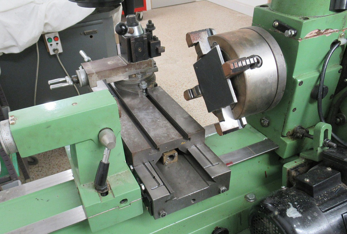

18/06/2023 11:09:01
Posted by Hopper on 18/06/2023 10:52:04:
Posted by Justin Thyme on 18/06/2023 10:29:51:
Posted by Nicholas Farr on 18/06/2023 06:54:47:
Hi Justin, don't you have a self centring three jaw chuck as shown in JasonB's second photo?
Regards Nick.
Edited By Nicholas Farr on 18/06/2023 06:58:06
Yes, but they don't take square bits, and even if I rounded the outside first they would not be big enough.
If you look at Jason's pic, the three-jaw chuck is holding the job by the round hole in the middle. But you need to have the reverse jaws for your 3-jaw to do this.
Aye, but I needed to create the hole in the plate first, I was wishing to do this on the lathe. I had wanted an excuse to use the 4 jaw chuck.
Now the hole is created (on the pillar drill) I can move on to the three jaw chuck to form the outer edge. (and yes I can soon get it into reasonable roundness with the angle-grinder before machining on the lathe

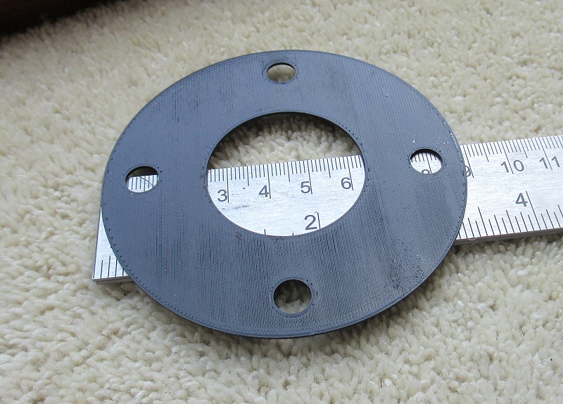

I am needing to form what can best described as a large washer out of 3mm mild steel late.. 39mm dia centre hole, with a 89mm outer edge.
I am suspecting that ‘(p)late’ is actually 5mm, not 3mm? I’m certainly hoping it is not two unattached pieces measuring a total of 6mm! That could be positively dangerous!
If two pieces, please securely fix them together before machining.
Drilling/boring and affixing to an arbor might well allow clearance over the cross slide, if those corners were sawn off or removed with an angle grinder.
Indeed it was two 3mm plates. In what way could it be dangerous, it seemed very secure.
I'm sure I would be soon aware if there was any looseness, and once the hole saw was engaged then the work piece would be trapped between chuck and tail stock ?
18/06/2023 10:36:32
Posted by JasonB on 18/06/2023 07:02:38:
Could you not have held it by the outer step in the jaws? That would mean none stick out beyond the body of the chuck, might need a bit of packing if the jaws meet in the middle before they tighten onto the work
As for clocking the hole true. I did show a 3 jaw which will not really need clocking unless it is well out or you are after high accuracy. If using the 4-jaw with a thin piece like this you could put the dti onto each jaw face, when they are true the work should be too. Thicker work can be done by initially gripping half the depth of the work so you have an uninterupted surface to run the dti on then move it back for machining
Yes it was too small for the outer jaws, packing would have seemed a bit precarious.
As for the centring of the hole, this, by luck was not necessary, however I was curious if I could have centred it, had I need to enlarge or improve the hole - something I may need to do in the future.

17/06/2023 23:49:40
Got a start on it today, as ever, it didn't quite go according to plan. As you can see the slide thing (whats it called?) was in the way and too big to go under the chuck, and this meant that I could not get the tailstock any where near the work piece. I could have removed the top part of the slide thing so as to get it under the chuck, but it seemed like a lot of effort. What should I have done ?
So what I did do was drill out the centre holes on the pillar drill, here I was very luck, the hole saw is supposed to be 36mm, but our hideous pillar drill is so unconcenteric (is that a word) that the hole turned out to be very nearly 39mm, a little bit of work with a file and it was perfect.
The other prob that I encountered (and I'm hoping for a bit of advise) I tried to put the plate after the 39mm hole was created, but just could not get it centred, I have one of those dial things for checking concentricity, but couldn't set it up on the inside of the hole.
