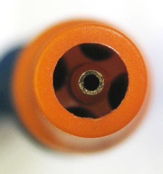

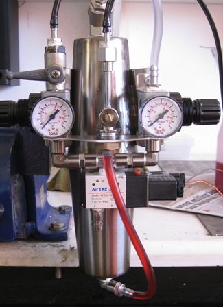

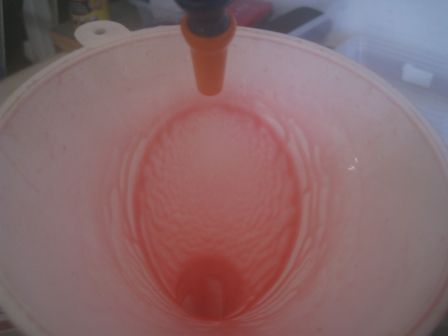

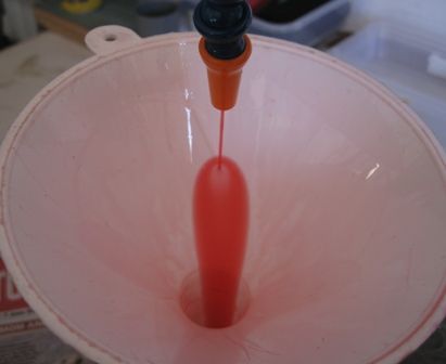

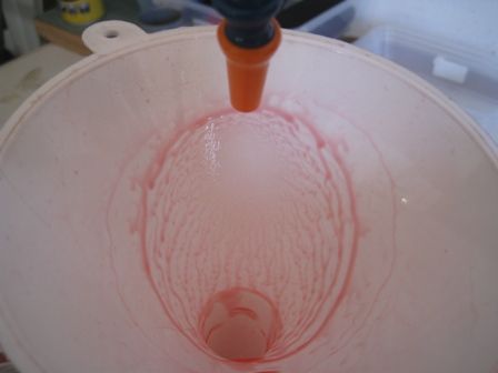

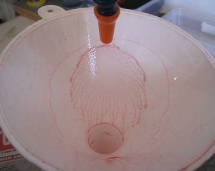

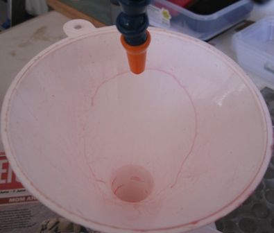

These type of systems should not be referred to as 'Mist cooling systems' - The ones that have earned similar system the bad reputation do just that - generate mist - and that is NOT what you want. If a mist results, very little of it ends up at the cutting tool tip, a lot ends up all over the work area and in your lungs, etc. If mist is being created it is a sure sign of excessive air velocity at the mixing nozzle. The aim is to have micro-droplets of the fluid trapped in the airstream, certainly no mist. If you see fog at all, and it floats about, the fluid has been atomized and that is not desired and hazardous to your eyes and lungs.
I built such a system and posted here about the build - A pressurised fluid chamber with the fluid entering the mixing nozzle where it met with and was entrapped withing the low velocity airstream. It works very well, but only did so once I fitted pressure regulators in both air feeds. A single air line feeds both regulators, with a air solenoid in line, activated by spindle on. When turned off, the solenoid vented fluid tank pressure to air so the fluid flow stops right away. The fluid tank outlet to the flow line is via a needle valve to be able to set fluid flow volume to suit fluid viscosity, etc. - I use only neat cutting oil, no water soluble types, so viscosity plays a bigger role.
The nozzle design was a bit of effort too..
All in all, a bit of a pain to set up, but once running, a pleasure to use.
Don't know how to post a referral to my specific posts on this, and don't want to repeat the whole thing here, but here are some photos..
1 'drop' per sec with air
1 'drop' every 2 sec, with air
1 'drop' every 5 sec
3 drops per sec with air.
Flow stream , no air.
Nozzle. Air flows around it, inside the blue tube in the background. Fluid flows from a small hole in the nozzle tip.
Hol is 0.7mm OD
Joe...

Joseph
Lovely job.
I think I'm going to steal your design and retro-fit my Bjur systems. The standard set up is just too hard to get reliably set at the right flow level. Probably crud build up in old age.
Bjur use a slightly smaller nozzle, about no 75 drill I think, and slightly different mixing arrangements. Only one regulator so air and tank run at same pressure but I don't thik thats a great issue as there is a needle valve to regulate the oil flow. Supposed to run at around 22-26 psi but open the valve wide and up the pressure and the results are lethal!
Clive
Joseph Noci 106/02/2021 20:44:53
1323 forum posts
1431 photos
A large part of success lies in the nozzle. I can turn up the air volume high enough to blow chips out of a groove being milled, without mist developing. The trick is to have a large area of air exit at the nozzle, and to have the fluid exit hole well past the airflow nozzle tip, ie, the fluid outlet tip in my nozzle is about 6 to 7 mm outside the air nozzle outlet tip. That way the venturi effect is almost negated and the fluid is transported down the center of the airstream . The fluid outlet must not be at an air expansion point within the airstream, as it is at that point that a drop in air pressure occurs, and the possibility of atomization arises.
Joe
