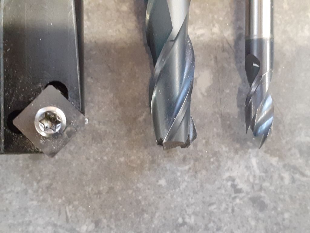

To help me set my 4 jaw chuck I need to make a couple of chuck keys. Ive barely used my Amolco mill as yet but would like to make them as aesthetically pleasing as the one pictured above indicated by the pencil. I have a square ER32 collet block so if i can find a suitable length of bar to fit it milling the 4 flats should be ok. I was thinking of milling it with the round bar horizontal.
But its how to add the bevel detail? I could probably make a good mess of it with a file, but was wondering how those with experience would mill the details?
Mill the flats horizontally then set the collet block at 45 degrees in a vice?
Mill it all with the bar vertical & then the details at 45 degrees?
Thanks in advance!
Chris.

If you use a flycutter rather than a milling cutter you can get the chamfer cut at the same time with a suitably shaped cutter. I'm a one key man myself.

This is a Flycut one I just did, found a likely looking toolbit so did not bother to grind anything special.
A few other options would be indexable tool, blunt endmill with corners freehand ground to 45deg or a chamfer mill to do the angle after first machining the flats. Last two could also do it with the work vertical and use it to do the flats and chamfer all at one setting as the sides cut as well as the angled end..
