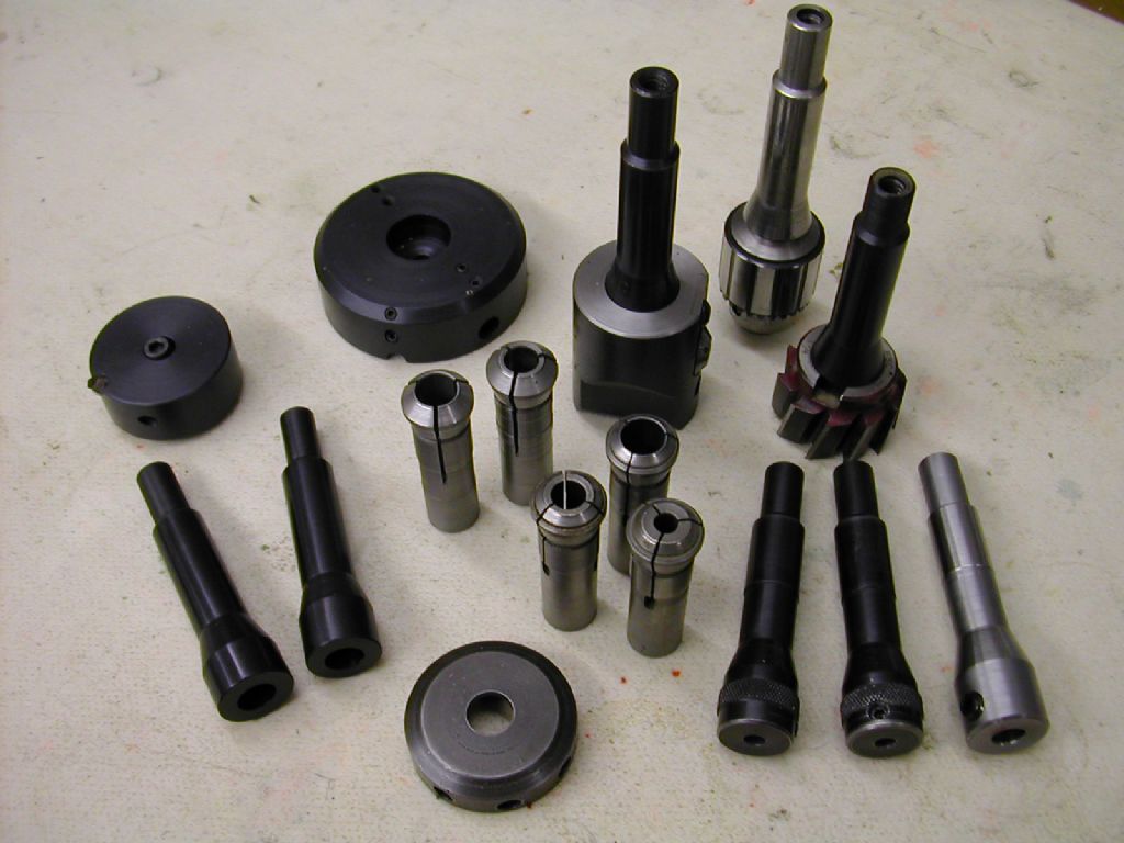

Hello Ian,
Clarkson made straight shank FC3 cutter holders for using with an Autolock Chuck - 6mm and 1/4" diameters with 16mm and 5/8" shanks. I don't think they are available now though but may be wrong.
I have been using two home made versions that fit directly in my mill spindle for many years - they are easy enough to make just ensuring concentricity is all that really matters. Made from tool steel but unhardened they have more than lived up to expectation - been using the mm one this very afternoon

I have just had a look on google - can't find an image of one anywhere but heres a picture of mine that may give Ian an idea
The two tool holders are bottom right beside the un-blacked 10mm dia version. All this tooling is 'soft' but made from tool steel - similar grade to silver steel, The five collets are from silver steel. I remeber my foreman at the time telling me they would be no good if they weren't hardened - well - they are still in use today
My old Linley mill has a spindle that takes Schaublin collets - basically a half size R8 - no tooling or collets were available when I bought the mill hence the need to make some. This is all well over 35years old, the collets even more so so has stood the test of time
Obviously the drill chuck, cutter and boring head are bought in
Hope that helps Ian a bit more
