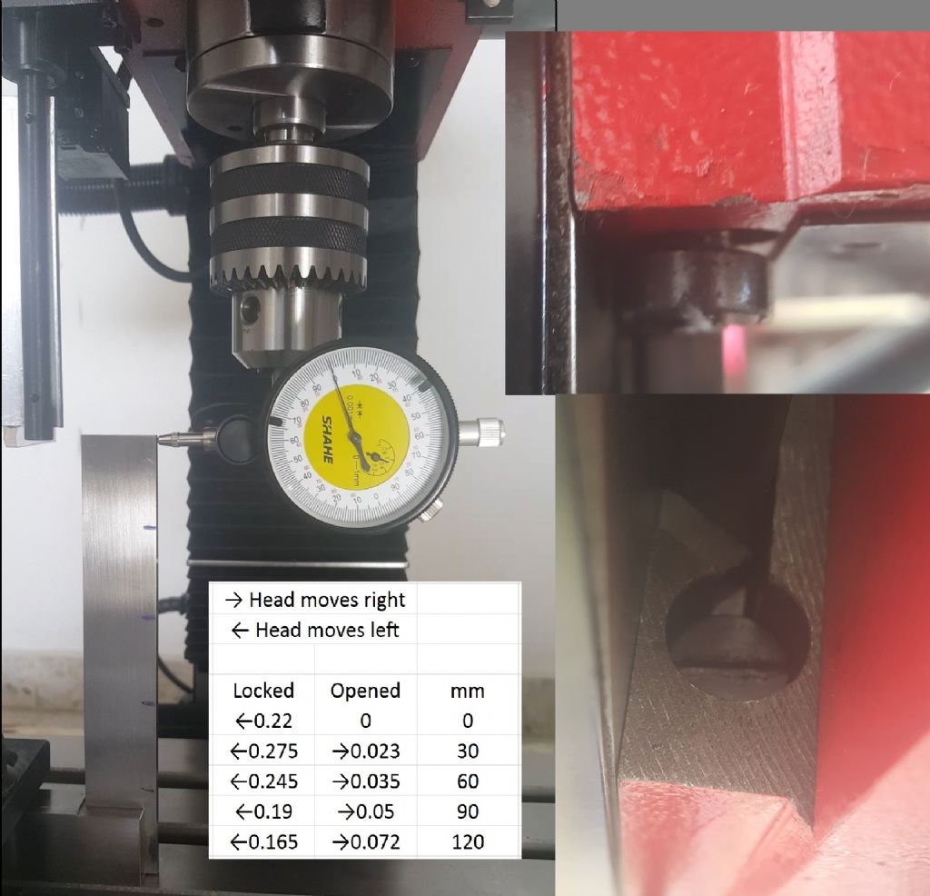

Hello,
I have recently bought a Sieg SX2.7 and wanted to share with you my experience, when I checked the alignment of the table relative to the head I found deviations in the order of 0.1mm, checking the alignments relative to the chuck I found out that the right side is of by 0.2 mm the left side is off by 0.12 and the left to right is of by 0.4 mm. There was also paint problems and rust and bent back cover. and the table was flat to only 0.05 mm. I talked to the seller and he agreed to replace the mill for me for free. I was happy for a while until I got it and realized the same story in a different version! This time the head was moving to the left by 0.2mm when it was locked and when I closed the gib all the way down it changed to 0.1 mm which is still a mess and the head couldn’t move all the way up. I also found that the head is tilting back while the spindle is also tilting the same amount - meaning that if I fix the tils of the spindle my head will be at an angle of 0.25mm over 15 cm. This time one corner of the top-back cover was sheared apart and they simply apply post paint in a brutal manner to cover it up. Bottom Line - based on this to machines it seems that they assemble the mill and that’s it. You must align it yourself. -The problem is that you cannot! apart from the gibs and the base of the column there is no way to adjust anything! the only way to fix it is by taking it apart and paying for someone to machine it for you bottom-up. which will cost the same amount as the machine does... If someone can tell me if the Sieg SX3 is more accurate I will love to hear that, and if someone has any suggestions please do tell I am very frustrated and I need a machine which is at least 0.05mm accurate. Thank You.

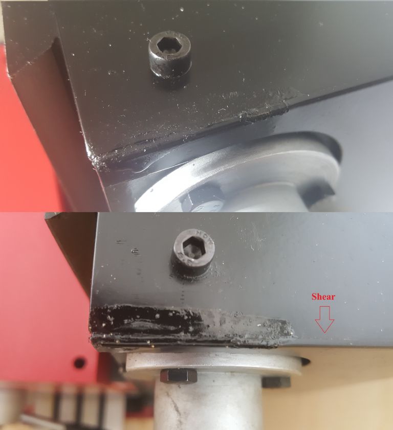

I am surprised to read that a corner of the top-back cover on the second machine had 'sheared apart'. Could you show some pictures of this?.
It is true that most Chinese factories will touch up paintwork where it may have come off, be it SIEG or any other. With reference to alignment, ALL Chinese machines in this price range are first assembled, and then checked and adjusted for alignment. Possibly not the best practice, but that is the way it is.

Nir Somthing25/09/2020 20:10:07
23 forum posts
16 photos
Part 1
Hi,
First of all I want to say that I am very impressed by the responses, I thought this post will never get any feedback, Thank you for your time, it is very nice of you all.
Regarding my background, I am Material Engineer, however I am deep in Mechanical Engineering since basically ever.
My experience is very little with mills however I did see hundreds of videos online by now, and I have a press drill which I added to it a x-y table and a DRO, not for the sack of milling but for accurate positioning of holes. That said, when I contacted the supplier I mentioned that my press drill has a play of around 0.5mm when I center holes (the play is in the quill not the table), and he said that I can be sure this mill (Sieg SX2.7) will be in the range of hundreds (~0.01mm).
So I decided to buy it. Here, in Israel it costed me 3,000 USD! Two times the price one will pay in Germany, USA or Canada!
I must mention that for the first mill that I got I didn’t touch the gibs and only cleaned the machine properly according to a series of videos on YouTube by Frank Hoose. I didn’t see any play, so I didn’t bother – definitely a mistake. However, when testing I always locked all the axis not in use.
At first, I used a centering Indicator to measure the table normality relative to the spindle, however the Supplier gave me a number of a co-worker who is a Mechanical Engineer and he said that this is not a valid test. So according to him (and videos seen on YouTube) I built a rigid angle made from a rod of 10mm diameter of SS304 and 20mm aluminum block that I connected to the spindle and measured the end of the table. The radius was 35cm and I measured the right side to deviate by 0.2 mm and the left side to deviate by 0.12 mm the left to right deviation was 0.42mm! When I used parallel to measure the flatness of the table it was across the y axis about 0.04mm, I could see light going through easily. When compared to my old x-y table this looked terrible to me... I also measured the table height relative to the head which was around 0.1 mm on top of that I had paint that fell of at some places and rust on bolts and the overall experience was not good. So the seller gave me the option to get a replacement. – It is unfortunate that at this time I didn’t thought to adjust the gibs.
When I got the new mill, this time I reassembled the gibs and tighten them properly (first only in x and y than also in z). I used the centering indicator that I was told is not a good indication and it was spot on! 0.01mm deviation over 20cm.
And when I used my right-angle tool that I have built I measured 0.12mm on the right side, 0.16mm on the left and 0.09mm right to left. That made me think – “great” I can shim the column and it will be perfect!. Then I measured the table relative to the head not the spindle. I got 0.09 mm change on the right, 0.13 mm on the left and 0.03mm right to left. So again, only need to adjust the column. BUT – in the first measurement, the higher side of the table was the one close to me, on the second measurement the higher side was the side next to the column! At this point I knew I don’t have a problem on my x axis only on my y axis but then I found out:

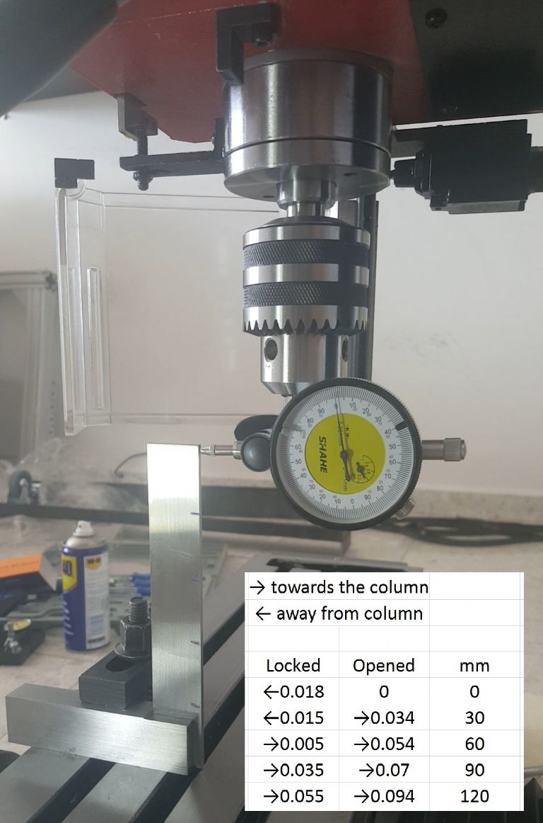

I saw that when I tighten the head the dials move all over the place, so I measured its movement, and the head moved to the left by 0.2 mm when locked. So I tighten the gib all the way down the movement only changed to 0.1mm which is still not good compared to 0.05mm in x and y axis. I then moved the head up and at some point the head got stuck! After some inspection I could see that first the head is not centered it is pushed to the left, and second that the milling done on the column bed is uneven. And in essence, the bed has a trapezoidal shape. So I either lock the gib all the way in and lose ~7cm of the top of the column or release it and have a play of ~0.15mm when locking. So at this point I thought maybe it doesn’t matter if I lock it all the time but again I was wrong! I took a machinist right angle tool and attached it to the table. And marked every 3 cm the height, then I measured the movement of the head relative to the table, I found out that when I don’t lock the head I move 0.1 mm in one direction, when I tighten it I move in the other direction by 0.16mm and that is over 15cm.
So, from the last measurements I realized that my readings are changing relative to the height of the head, that is why I got a spot-on measurement with the centering dial and not with the tool I made. (The height with the centering dial is probably the same height for which they adjusted the gib since it is tight at the top and loose at the bottom).

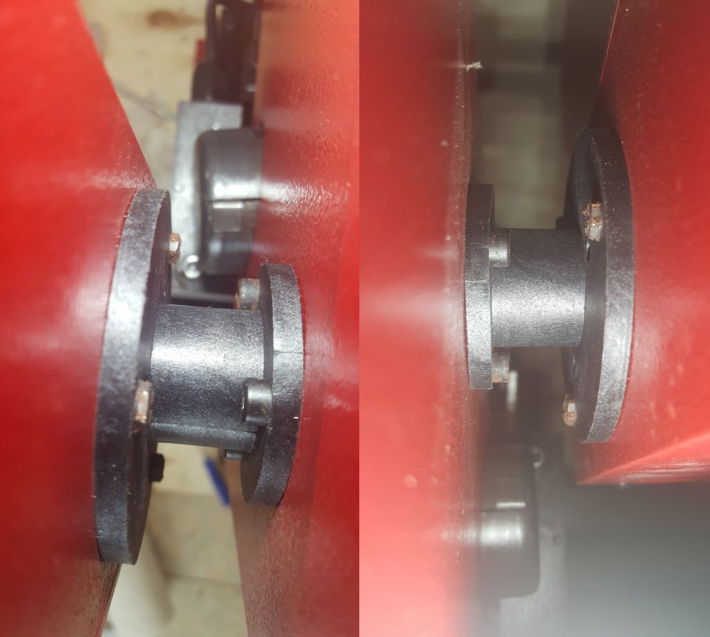

Regarding one of the comments, the second mill cover at the back was sheared at the top as if it got hammered and sheared open, and they simply someone took a brush and painted on top of it (the brush was full of sand or something of the sort&hellip

When I say right side, I mean to say deviation of the right side of the table - that is the y axis
When I say right-left I mean to say deviation of the table from right to left – that is the x axis

Nir, as mentioned by Ketan it would help to see some photos of how you are testing the machine then those answering will be better informed to offer help. There is nor restriction on how many posts you need to make to add photos either hosted elsewhere or added as described here.
As has been said the machines are checked at the factory and meet whatever spec is required. The fact that both your machines showed signs of physical damage which could go deeper than just paintwork or bent outer covers could have happened in the shipping container or even by whatever courier was used to deliver them. The second one having been repainted would be less likely to blame on the courier though possible you were sent a replacement that was already a customer return. This damage may well be the cause of some of your readings.
You have not replied if you took the machines apart to get them into position as this again will affect the column position. On both the SX2.7 and X3 that I have here I took them apart to lift onto the bench and reset the tram as I put them back together, both have a feeler gauge shim in place to get the tram I was happy with. Neither machine have had the full strip down and rebuild like some Youtubers show, just broken down into a couple of parts to make lighter and then put back together.
As you have found on a machine in this price bracket there will be slight errors between the travel of the head and the travel of the quill but I have not found much needed to get these to levels that are acceptable to me beyond simple gib adjustment. This video shows the readings I get off the SX2.7, Tram within 0.01mm over 140mm diameter, Head movement 0.015mm over 50mm and quill 0.04mm over 50mm ( it's full range of travel) all within your 0.05mm though you do not give a length over which you need that accuracy so a bit meaningless as a stand alone number. I don't have any 100% true parallels ( does anyone? )but I'll have a measure for table flatness and report back later but the tram readings suggest it is flat to within 0.01mm
I don't know what use you intend to put the machine to that requires your desired level of accuracy but a look through this album or this playlist will show what I have done on my Sieg machines. If you really do need more accuracy then I would suggest you need to up your budget to more than a Sieg machine and your suggested same cost again for blueprinting it. so somewhere starting at $10,000USD.

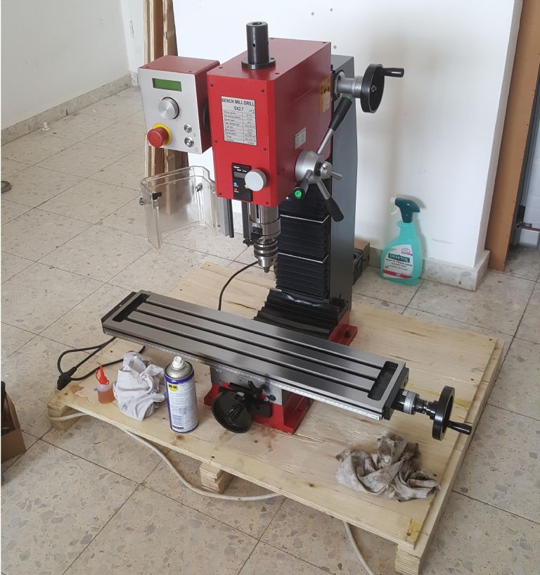

Nir Somthing26/09/2020 08:16:56
23 forum posts
16 photos
JasonB,
I didn’t took the machine apart, I check it still in its box, I added some wood blocks underneath to reduce the movement of the mill, I am sure it will change when I pace it on a proper table, but I don’t buy the claim that it will change completely, it will move probably but no more than a few hundreds (~0.02 mm). I only cleaned it truly and removed the gibs, cleaned them, applied little engine oil to them by hand and locked it until I had proper resistance on the handles. Which gave about 0.05mm movement in the x and y. But as I mentioned, I have the real problem in the z axis, as I described earlier.
When I said 100% true, I meant that I didn’t made the parallels myself, I bought them, and they are supposed to be within a 0.01mm accuracy.
My intension is to have the ability to make two part with a few holes at certain location, and not worry that the holes will be aligned, I am tired of making bigger holes to account for deviation of my old press drill. I have no idea what I will do with it in the future but milling accurate parts could help me a lot. For my work real 0.1 mm will be perfect but over ~50cm. Error adds up as you already know, and I expected this machine to be a lot more accurate.
The serial number on the first mill I got was 90415 and the one on the new mill is 90414.
Since everyone seem to not trust my measurements, I have an idea, I can ask the seller to check the first machine that I already returned, by a professional, it will cost me around 200 USD. And if he confirms that the machine is inaccurate, we know the problem is with the machine. If he confirms otherwise, we know that I am the problem, and I can ask him to return the machine to me – but then I will be sure I got a good mill.
As for your videos, I did the same tests, except that I used the chuck since the ER collet that I ordered a month ago is still on its way… And buying it here is not an option.
I am afraid from the rust since I know that it may shorten the life of the circuitry.
The paint is just cosmetics – but it indicates the “quality assurance”
Note I have a different panel and a feed lock handle.

It's helpful to see and understand exactly how a test is carried out because there are many variables involved.
You mention adjusting the gibs ' Which gave about 0.05mm movement in the x and y.' Assuming that is 'play' measured somewhere it sounds excessive, and that much side to side movement would be enough to allow the able to shift or tilt out of being square to the column. Without seeing how you made that measurement, it's not really possible to understand if this is an issue or not.
I'm not trying to criticise, just to explain some of the hazards of trying to understand such measurement at a distance. Very often, ten minutes spent with the machine could replace hours of headscratching on line!

As far as I am concerned, the rust and paint touch up you have highlighted is not a big deal. Some people may disagree. Regarding the inaccuracies to which you refer, this is really a matter for you to take up with your supplier. To build up a case to present to your supplier by directing him to this thread to refer to every ones opinion is speculative and wrong. What you really need is an experienced machine tool fitter in your country to assist you to make the necessary adjustments as he feels appropriate, to meet your specific requirements. This is different to your suggestion to get a professional to check out the machine at the dealer for USD200. In my opinion, if you are paying for it, it may be better for you to discuss the matter with your supplier to get an experienced machine tool fitter to assist you, with mutual agreement between the two of you. Although, I am still uncertain if the fitter or anyone else will be able to solve your problems. It may also pay you to do a milling coarse of some description.
