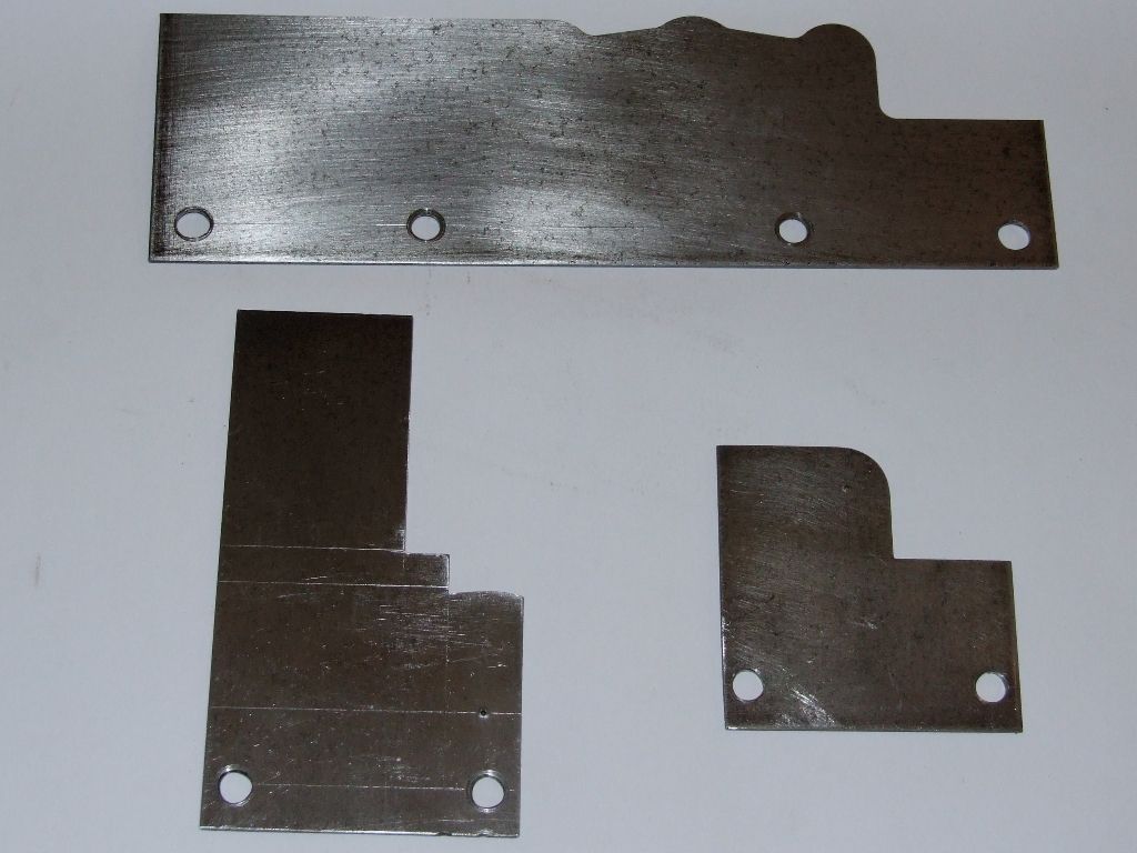

To complete the picture the drive pulley on the crankshaft for the governor is also crowned:
SInce this pulley only has one flange the crowning was machined using a hydraulic copy attachment and a marked out and hand filed pattern; the one bottom right:
Does this count as hand turning? smile
Andrew

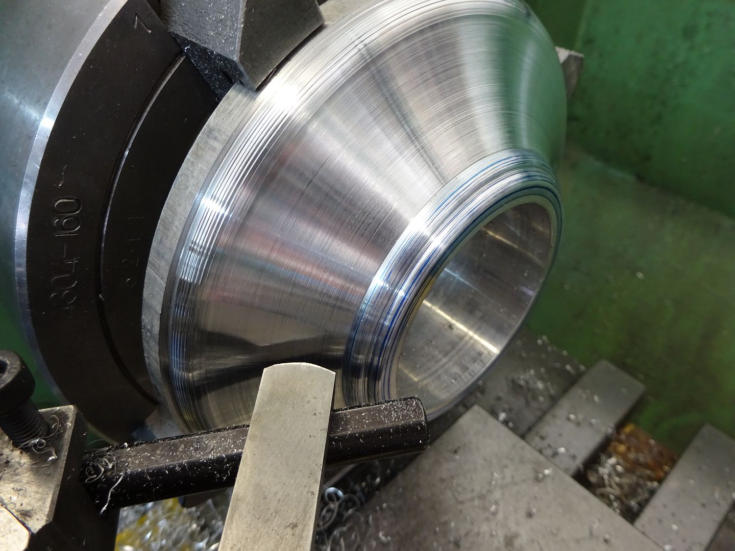

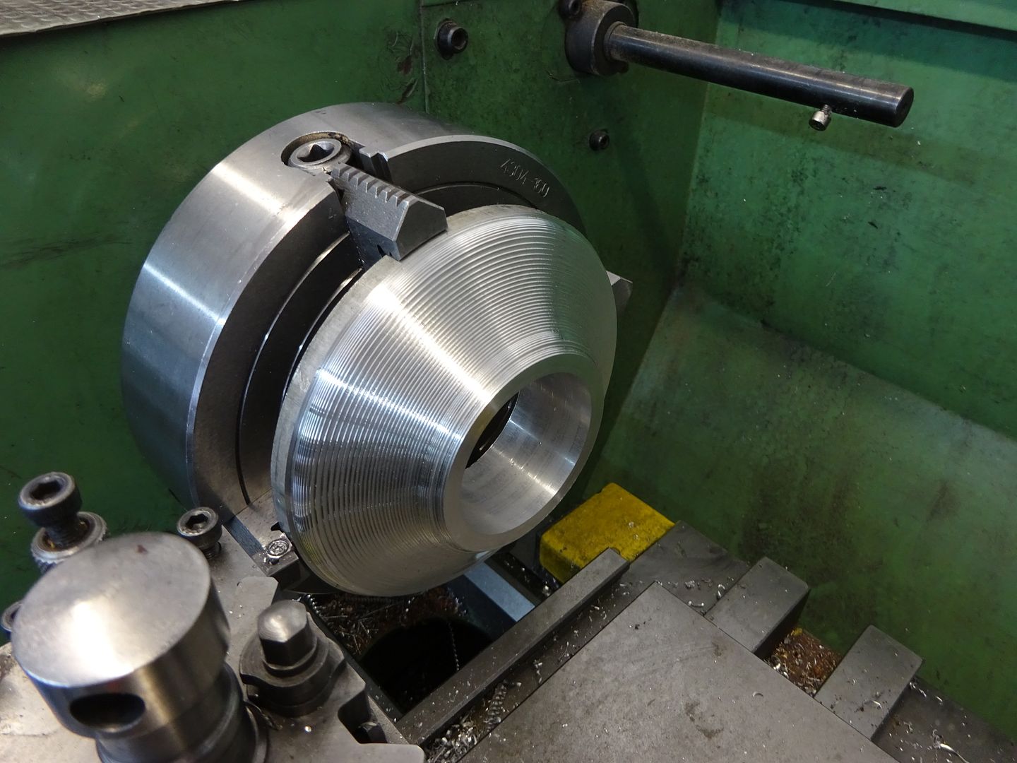

Although the OP said he did not fancy doing it by hand it is not too hard, even if you opt to do the blending by file similar methods can be used.
Draw out the profile and work out a set of co-ordinates so the work can be roughed with teh handwheels or DRO and simply blend which is much like dot to dot.
0.020" increments
Woodturning scraper with boring bar used as a rest
Works on steel too
