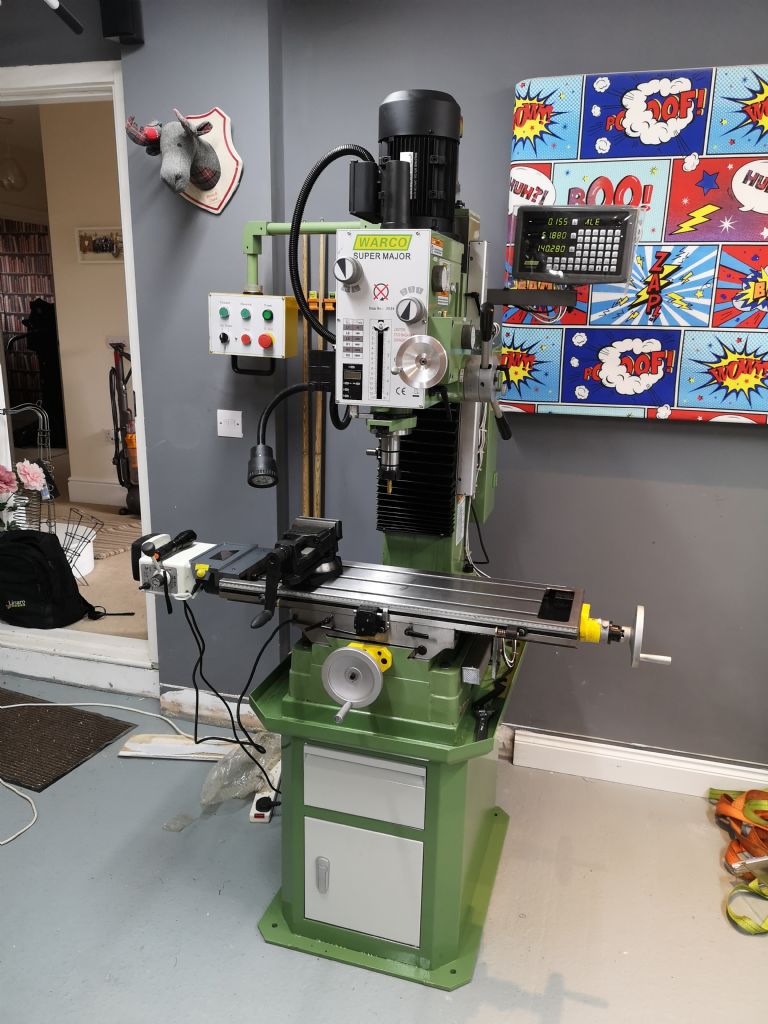

I've been meaning to fasten down or otherwise stabilise my Warco Super Major Mill for some time now. Even with everything secure and the gibs tightened, it still has a tendency to vibrate (a lot) and wobble (a bit) on it's current flat base.
However, I'm not quite sure of the most favourable means to accomplish the task. The issue is my lack of trust in the quality of the concrete in the garage and the fact that I'm not keen on drilling a bunch more large holes in the floor.
Is there another way to gain a similar level of rigidity? Perhaps some rubberised feet?

Bolt it to the floor then no risk of it toppling over and more rigid than rubber feet

Straight to the floor but make sure there are no gaps under the feet, if there are add shims. You can use sleeve anchors or thro-bolts which will just poke through the hole so mill won't need moving.

Posted by JasonB on 19/05/2020 13:54:26:
When you have done that get a wall socket fitted so that lead does not run across the doorway
Edited By JasonB on 19/05/2020 13:55:26
Don't worry, that's an old picture. I have since wired 6 new sockets into the existing ring main.

I'm certainly not concerned about tipping it over. It takes all my weight and lifting power to tip it enough to get something underneath it (rollers, etc). I just want it to stop sounding like it's going to bring the house down if I take more than 1mm DOC.

Fixing the stand to the floor may not help as it is probably the thin sheet metal that is vibrating and flexing. Build a new stand out of breeze blocks and cast in place a concrete top. Don't glue it to the floor with cement the weight will keep it in place but it can still be moved if necessary. Very cheap and if it doesn't work you can still use the parts in the garden for a BBQ.

None of my milling machines are bolted down. Doing so may help damp vibration, but won't stop it. A better idea would be to cure the vibration in the first place. The first thing I'd look at is cutting conditions - quality of cutter and it's sharpness and cutting conditions such as spindle speed, feedrate and depth and width of cut.

Posted by Bazyle on 19/05/2020 14:21:56:
Wow, lots of empty floor space!
Not anymore I'm afraid. That's a pre-lathe photo. The workshop is now quite full.
That stand is not made from thin sheet metal. It weighs more than I do.

Does it vibrate when it's cutting or just running.?
Is it just panels or drawers rattling or is it really vibrating (a lot). In other words does the noise make it sound worse than it is.
It is a mill so there should be very little out of balance rotational mass with the exception of fly cutters so the vibration can only be from the cutting action or the motor.
I'm with Andrew on this one. Track down the source first.
