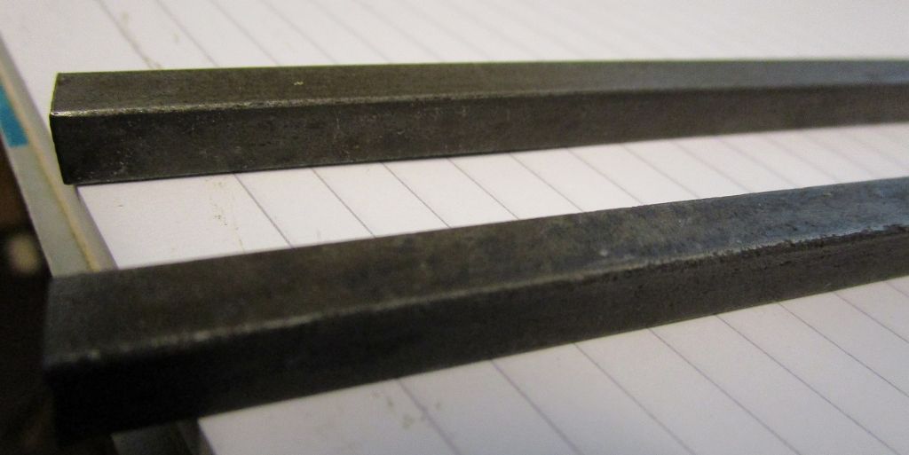

Hi,
I have just received 2 bars of 1/4 inch square silver steel. The previous silver steel I have bought has been from other suppliers and has been shiny and new looking. this looks more like mild steel. Being inexperienced I thought I would ask you guys whether it is usual for silver steel to look like this before chasing up the supplier.

pgk pgk19/03/2020 10:53:19
2661 forum posts
294 photos
Typically I've bought it precision ground - hence shiny as you say. Cut a bit off, heat and quench to see if it skates a file.

Frank Gorse19/03/2020 10:59:39
104 forum posts
Silver steel and gauge plate are usually supplied ‘shiny’ from the grinding process. If this is discoloured because it’s very old stock ,as it may well be,it should be described as such when you buy it. One clue is that silver steel should be accurately sized to half a thou or so,bdms is usually a bit undesize.

Clive Brown 119/03/2020 11:03:49
1050 forum posts
56 photos
I bought 1/4" sq. silver steel years ago for lathe tools to make my "Quorn". Looked like BDMS but turned a tough steel casting for the work-head just fine..Incidentally, IMHO, silver steel is much under-rated for making special purpose cutting tools.
J Hancock19/03/2020 11:08:47
869 forum posts
You could tape a piece of known silver steel to it, push them onto the grinder and see if the 'sparks' look identical.
Perhaps with a piece of mild steel as well.

ega19/03/2020 11:15:53
2805 forum posts
219 photos
In my experience square silver steel is supplied unground.

SillyOldDuffer19/03/2020 11:28:57
10668 forum posts
2415 photos
Posted by Chris TickTock on 19/03/2020 11:00:22:
... confirmed they are silver steel and apparently old Stubbs Stock...whatever that means.
Stubs were a well-known brand in the good old days. Some believe it's better than modern Silver Steel and pay extra for it. I'm suspicious of Stubbs because the maker was actually called Stubs. Maybe 'Stubbs' is any Silver Steel, just as 'Hoover' became the generic word for any vacuum cleaner.
Never had Silver-steel rod arrive other than brightly polished, but my slab of gauge plate looks just like BMS.
Today's lesson, you can't really tell much by eyeballing metals. The steel-rods out of old printers look just like silver-steel but aren't. Brasses have such a huge range of different properties as to be almost different metals. Spark testing and magnets are clues, but to really know needs a chemical or spectroscopic analysis plus mechanical testing.
If you have silver-steel or gauge plate it will heat harden. Otherwise it won't.

Andrew Johnston19/03/2020 16:36:40
avatar
7061 forum posts
719 photos
Square silver steel used to be available, but it's pretty rare nowadays. Square gauge plate is still available and is ground on all four sides, unlike rectangular gauge plate. The picture in the first post looks more like key steel to me.

old Al19/03/2020 18:05:00
187 forum posts
does the end of the bar have a cut or ground finnish?
I would not take the suppliers word for the grade of material as 100%. They are normally pretty good, but not always. It pays to check if you are worried
Roderick Jenkins19/03/2020 19:24:24
avatar
2376 forum posts
800 photos
As Andrew says, square silver steel has been rare for years. I managed to get some1/8" square a considerable number of years ago. It looks like Chris's specimens, it's unground, and mine certainly hardens and tempers like conventional silver steel.

Chris TickTock20/03/2020 09:24:03
622 forum posts
46 photos
Posted by old Al on 19/03/2020 18:05:00:
i take it by cut you mean flame but which would be rougher than an angle grinder or saw. Mine look cut with a grinder or saw. I can't see them flame cutting then grinding so will assume safe to use entire length.
