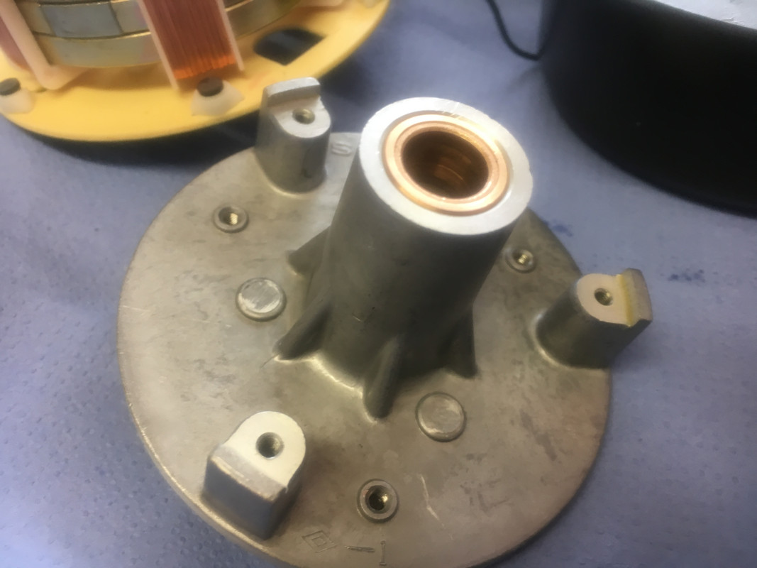

hi,
i would like some advice please on which small lathe (new or old) would be best for making some new bearings for my sony turntable.
i would like to make them in bronze or maybe delrin and also have a go and make the bearing housing in the same also.
could you guys advise on what lathe to go for that will turn to tight tolorences.
i should say im new to lathe work but my job is a steel fabricator.
here are some pics of the original housing and bearings.
thanks in advance.

This doesn't directly answer your question, but is there anything special about the bearings? They are quite likely to be a stock size (though may not be available from Sony), if so, there is no point in trying to make them. Also if you are concerned about high precision you will have to consider possible wear on the shaft.

the turntables dates from 1974 and is a high end example,no spare parts are not available anymore.
the oilites bearings are approx 11mm id and 16mm od,ive checked online a few times and it would seem the size is not a standard stock item,besides theres no fun in just buying off the shelf

Are the originals even Oilite/sintered bronze? They look very much like plain brass or bronze bushings in the pics. You can buy pre-made bronze bushes in a wide variety of sizes from bearing suppliers.

That said I'm with the comments above - Sony most likely used standard sized parts, and that does look like a plain bronze bearing. That should be fine for the speeds of a rotation table so it makes sense. The bearings will include tolerances for fit and rotation so the measurements will be slightly off from round numbers even new.
The housing itself seems be a die casting that has been finished off on a lathe. (The small stand up rounds around the center might pads for the die casting ejection pins). A lathe only is not the natural fit for making that.
Is casting the entire thing (house and bearing) in bronze and finishing off on a lathe an option?
