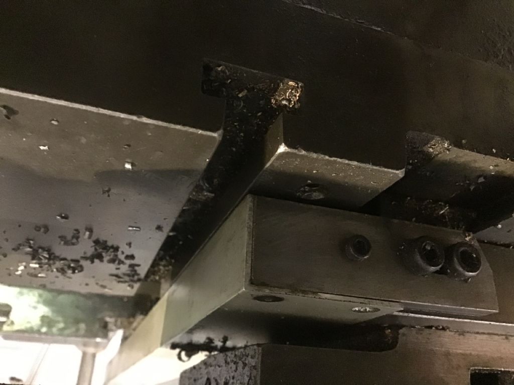

I fitted the smaller microsyn on my Colchester student On the right of the saddle, with a very thin piece of alloy angle to provide a shield. One of the newall black alloy angle mounting bars was mounted in the gap between the bed ways under it, used to stop the tailstock smashing into it.
Ill try for a photo in the morning
Zan03/12/2019 17:31:47
356 forum posts
25 photos
The thin aluminium  guard came with the set from newall  the mounting at the fromnt is slotted for positioning, the small screw end on holds the end of the sensor bar, which is mounted only at the front .  The cover is held in place with small cks “cap” screwse3e64b6d-bc4b-47b8-b0b3-d8045ad14015.jpegSeems the angle bracket also carries the sensor , it can be seen in both photosSry about the delay went to buy a loco but unfortunately the wheels were loose..... shame, was exactly what I wanted
Edited By Zan on 03/12/2019 17:36:50
John Parry 503/12/2019 19:47:38
22 forum posts
10 photos
Thanks for the Idea and the Photos Zan. I do like the Student its a nice size. John
