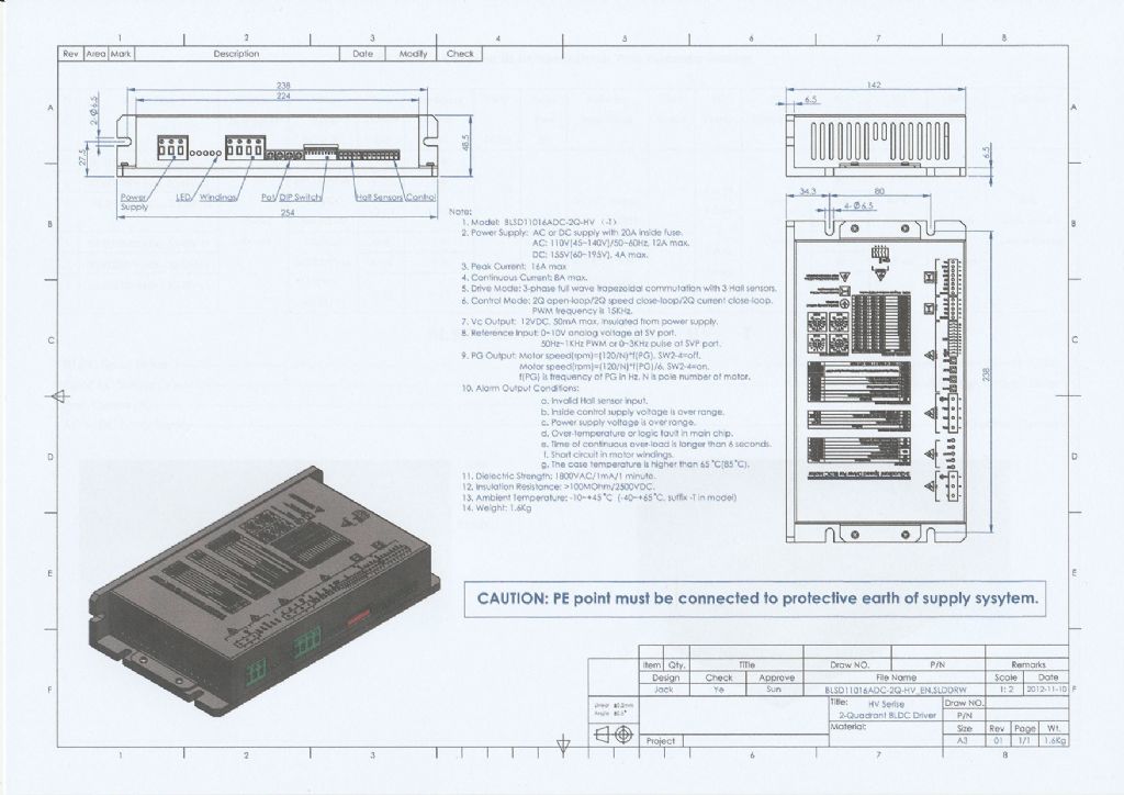

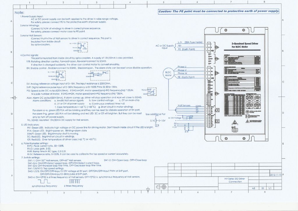

Mike Palmer 112/09/2019 12:04:50
32 forum posts
2 photos
I have found a motor driver suitable for the 230v DC brushless motor.
I connected power in to windings also hall sensors, and set various switches but no movement from spindle.
I have attached specs and notes, any help would be appreciated
Thanks
Mike
Edited By Mike Palmer 1 on 12/09/2019 12:07:11
Edited By Mike Palmer 1 on 12/09/2019 12:07:57

I know nothing about a Syil X3 CNC milling machine but are you saying it is fitted with a 230VDC brushless motor?
A brushless motor only becomes a 'DC' motor when it is combined with electronics, the motor itself is driven by several windings and they need the correct AC type waveform to cause the rotation.
The diver you have bought might be entirely suitable for the motor you have but the wiring between the two must be correct, most likely the fact that it is not running now is either a wiring difference or some other incompatibility.
What details are shown on the motor rating plate?
Ian P

JasonB12/09/2019 16:21:36
avatar
25215 forum posts
3105 photos
1 articles
What voltage have you got going into the controller, from what I can see it does not take 240V unless that is a typo on the second image.

JasonB12/09/2019 16:27:01
avatar
25215 forum posts
3105 photos
1 articles
I see that the motors supplied by the company the controler came from are 24. 36 and 48V they don't do 240V brushless motors as far as I can see
Mike Palmer 112/09/2019 17:16:28
32 forum posts
2 photos
Thank you for you input, but I am not an electrical engineer these charts mean not a lot to me. I can understand conect terminal U to Hall Ha and the like.
Jason
Same as above but looking at the Arc spares for SX3 motor states 230V DC all I can do is follow what others tell me!!
Mike

Nobody told you to get that controller, Andrew queried it after you posted the link and I'm also questioning whether the controller you have bought will work on the motor you have as it may well be for 48V. Have you asked the supplier?
Mike Palmer 112/09/2019 17:30:06
32 forum posts
2 photos
Jason
The controller I have bought is not the same one I showed in an earlier post, as got no reply from my enquiry.
Have you looked at the Arc motor spec? if so please tell me what you think the voltage is?
There are many 36, 48 60 v DC Brushless Motor controllers on the market, but as stated earlier I was trying to find one with 230V rating .
Mike
JasonB12/09/2019 17:49:02
avatar
25215 forum posts
3105 photos
1 articles
I would say the SX3 one from ARC is 230VDC
But best to look at what is on the side of your motor as Syil may have sourced parts from elsewhere, board could be different too as some of the Sieg boards are exclusive to them even if made by the same supplier.
Do you know for sure that it is not the motor that is at fault?
