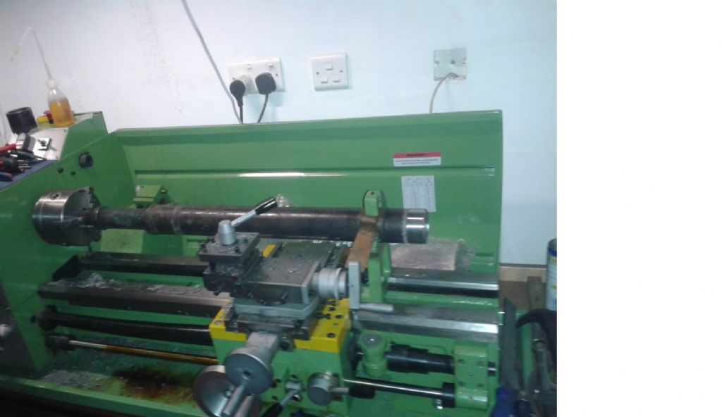

ChrisB09/08/2019 19:21:20
671 forum posts
212 photos
I think the spindle bore is never large enough! but I usually make do with what I have, especially for a one off.
Can't remember exactly what I was doing here, I guess it was shortening a cardan shaft... oddly enough it didn't come out too bad!
Edited By ChrisB on 09/08/2019 19:21:39
