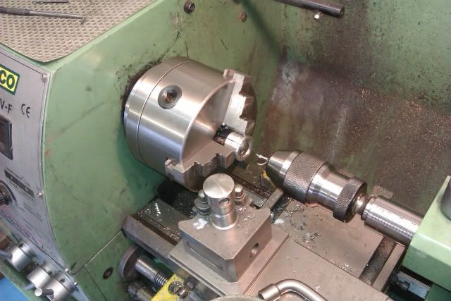

You can buy stainless balls that are not too hard so they can be drilled quite easily, these were 7/8"
Top hat bush to hold the ball for drilling so it does not get marked, easy enough with standard HSS drill

Like JasonB , hold it in a collet or a bush, drill with a tungsten carbide drill. Then you can also bore to the diameter you want with a carbide boring bar.
The ones I drilled out for my Noga stand attachments , was 7/16 ball , Spot drilled , with a carbide spot dril 1st for about 1mm deep or so, drilled with a 5mm coated carbide drill. I drilled at around 300 rpm, and used just compressed air to keep it cool and blow the chips away. Then bored it out to suite the pin of the attachment. Glued and assembled with 620 loctite, as a permanent assembly.
With Mine I just held the ball in the 3 jaw chuck, with a bit of printer paper around the circumference. Indicated the inside of the jaws true, (adjustable grip tru chuck) and did them. The paper helps with both holding the part and not marking it as well.

As said stainless would probably be best. No need for any special fittings, I’ve drilled balls held in a standard three jaw chuck.

I purchased a ball bearing of 25mm diameter and then held it in a three jaw Chuck and drilled it with standard hss drills, was surprised how easy it was, no problems.
