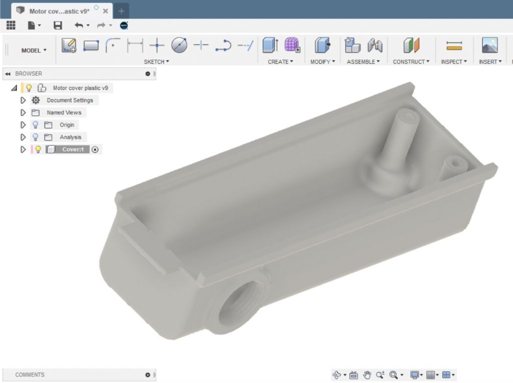

I recently bought a Cetus3D printer for under £340 delivered. This included the bonus pack which contained 2 large reels of PLA and several different sized nozzles. Took minutes to screw the subassemblies together and I had it up and running in no time. This one has wifi and like most it comes with its own software and slicer. It also has an iOS and Android app which is perfectly capable of running jobs and monitoring progress.
At the weekend I created a plastic terminal cover for a servo motor in Fusion 360 and saved it as an STL file, then printed it out on fine resolution over night.
Here's what it looked like in the Fusion modelling environment
and also rendered in Fusion just for fun.
Pretty impressed with the finish - it's just as good as what I was getting from the Ultimaker 2 which costs about £4k last time I looked.
There's an optional heated bed and you can get your own off ebay etc for £30-40, complete with digital controller if you want to use ABS etc.
Once the raft and supports are removed, the final result is pretty darned good. The M20 x 1.5 threaded hole was just right for the cable gland and the surface finish is excellent.
There's no enclosure and the std printer has unheated bed but the quality of the work is very pleasing. The printer itself uses Hiwin machine slides, which is a pretty neat approach. You can do a lot worse for the price and delivery was something like 2 days from the UK warehouse.
