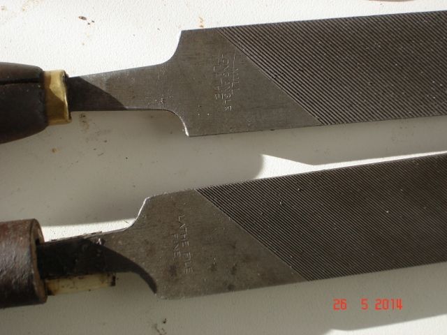

I'd go the file way, but I'v got a long angle lathe file (well 3 actually), these don't tend to clog up, and they must be ok on the lathe 'cause it's stamped on the file beside the makers name on at least one of them.
Ian S C
