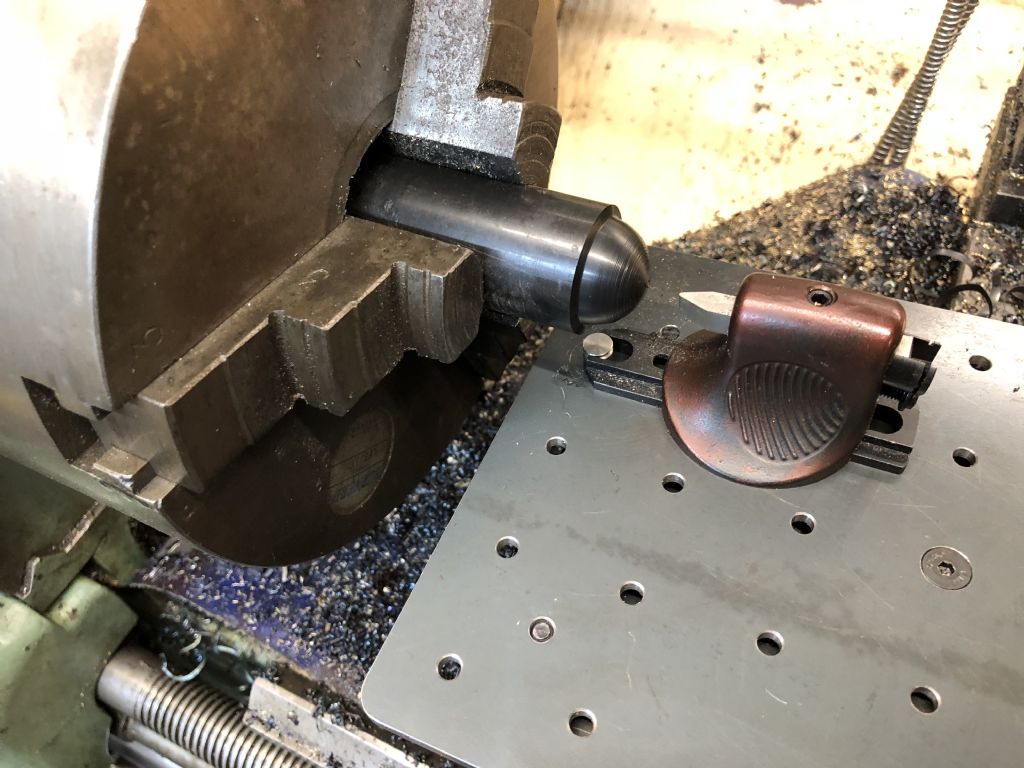

My Turnado arrived today and what a great piece of kit it is
The toolholder is indeed a thing of beauty
My lathe is a colchester 6.5 inch CH so to fit it i made a flange like the toolpost has so its really quick to fit just 2 bolts to tighten and its on.
Then the pillars wanted shortening to only 6.5mm so a rethink was called for ...i replaced the pillars with 25mm squares of GFS 6.5mm thick tapped a central 5mm hole and used the original bolts ...bolt 4 of these on and the bolts protrude just enough to locate the top on
The central one i made a 6.5mm plate bolted on the bottom plate and the original screw screws into the plate
First quick tests worked well on some 30mm dia black nylon
