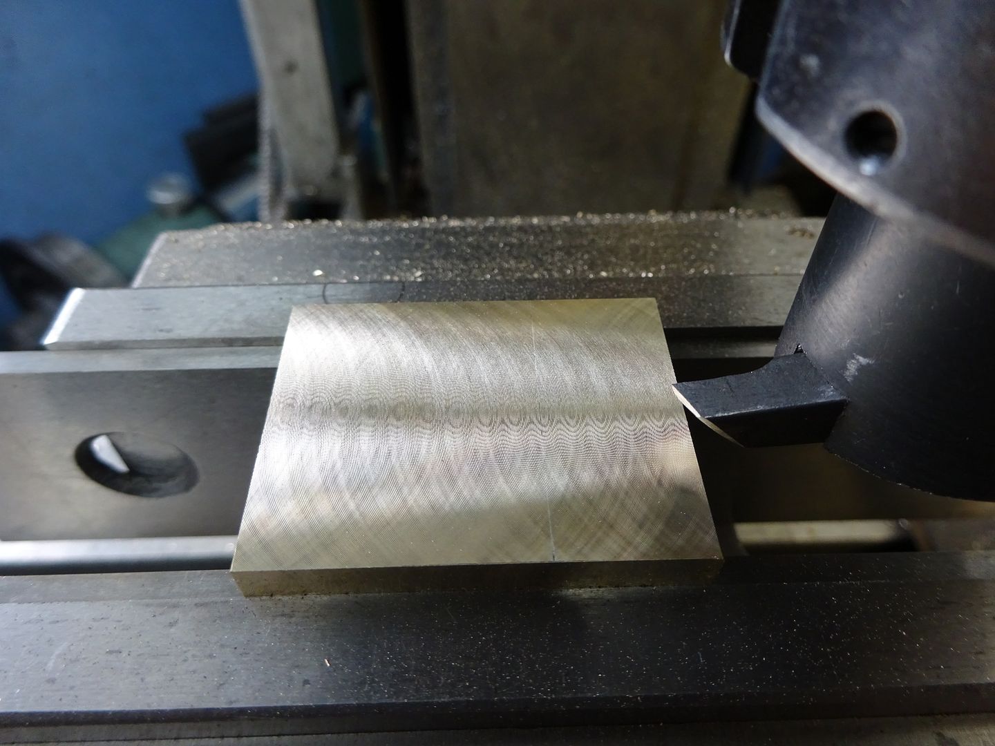

Posted by Neil Wyatt on 05/01/2018 19:11:12:
Also, unless the mill is trammed absolutely perfectly either only the leading edge will cut or the trailing edge will cut.
And when you get it set right you end up with almost a hologram or damascused look.

Posted by JasonB on 05/01/2018 20:44:50:
Absolutely true, but (a) how many people can get that* and (b) the only difference between flycutter and mill on that machine will be the type of pattern produced.
*Actually I've seen that pattern on the table of 'cheap imported drill presses' suggesting that the Chinese are very good at tramming their industrial-size mills
