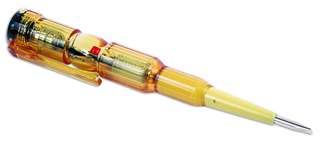

I got one of these a few months ago and have ended up buying half a dozen as xmas pressies
They can go right down to non contact low voltages from mains supplies and can do very low voltage/current stuff via direct contact, both ac and dc
So handy for the house, and on a car, for under a fiver from various outlets
They seem to detect EM energy but at very low levels can do contact work
Anyway, thought I'd share, someone else may find one handy
(EDIT They seem to do under 12v no problem, despite what the blurb says)
**LINK**

Ady114/12/2017 13:27:24
avatar
6137 forum posts
893 photos
Emergency stop press !
It doesn't seem to work in cars (dang!)
It only detects low DC stuff which originates from a mains supply

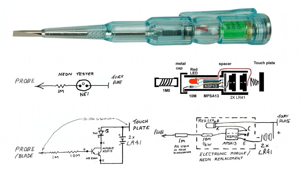

john swift 114/12/2017 13:49:06
avatar
318 forum posts
183 photos
the blade  is connected to the base of a NPN darlington transistor via a resistor of several meg ohms
to light the LED the screw driver blade has to be a volt or so more positive than the end cap/ battery negative terminal
if you touch the chassis with one hand and the tester/ screwdrivers battery cap with the other hand
the LED does light when the blade is in contact with a +12V DC connection
PS
diagram
Edited By john swift 1 on 14/12/2017 14:04:44
Emgee14/12/2017 14:13:51
2610 forum posts
312 photos
I don't think this can truthfully be described as a Tester, it only indicates and should not be relied upon 100% when using on any mains circuit. Similar to the modern Litestick unit which indicate mains voltage.

Best story I heard about these was somebody loaned theirs to the apprentice who managed to drop it in a bucket of water. After drying the outside he returned it. Next time the owner used it he got a bit of a wallop.
Mike
Michael Gilligan14/12/2017 18:40:19
avatar
23121 forum posts
1360 photos
Posted by Mike Poole on 14/12/2017 17:40:38:
... Next time the owner used it he got a bit of a wallop.
In the early 1970s, I worked briefly for a TV Rental Company, where the engineers carried the neon-only version of these testers.
A favourite trick was to replace the dropper resistor with a fuse surprise
With mates like that ...
MichaelG
alan-lloyd14/12/2017 18:57:58
avatar
183 forum posts
Exactly if that resistor goes short circuit you will be pluged into the mains, the electrians I worked with would never use them
peak414/12/2017 19:48:37
avatar
2207 forum posts
210 photos
Posted by alan lloyd 3 on 14/12/2017 18:57:58:
I've rarely, if ever, come across a normal carbon type resistor go Short Circuit, only go High Resistance, or Open Circuit.
Capacitors on the other hand...........
Regarding the little beepy flashy pen mains detectors, I've never been comfortable with them to detect the absence of mains, just the presence of a voltage. It's always hard to prove a negative.
The way I sometimes use one is to clip or place it next to the circuit to be tested, such that it is bleeping/flashing permanently. Then when you turn off the switch and the detector notices, you know you've isolated the correct circuit; assuming that it's not dual fed of course.
Also, even with a meter, test the tester before testing the circuit, to help prevent false readings.
Bill
