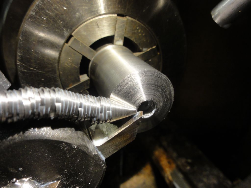

I know I am biased but a few jobs done on my mini lathe, admittedly with roller bearinmg conversion, but i never had any problems before doing it:
0.125" DOC (the manual recommends 0.01" max...)
Finish you can get parting off with a carbide tool (1" diameter):
2 1/4" diameter knurl using single wheel held in toolpost:
Capacity for swarf generation...
Parting off 1 1/4" steel using HSS tool:
As LBSC would have said, any questions?

I do have a question though. In the first picture why are there a series of radial lines on the cut surface? Chatter?

I don't deny it's brass, but it proves I'm not just an armchair machinist :-P
