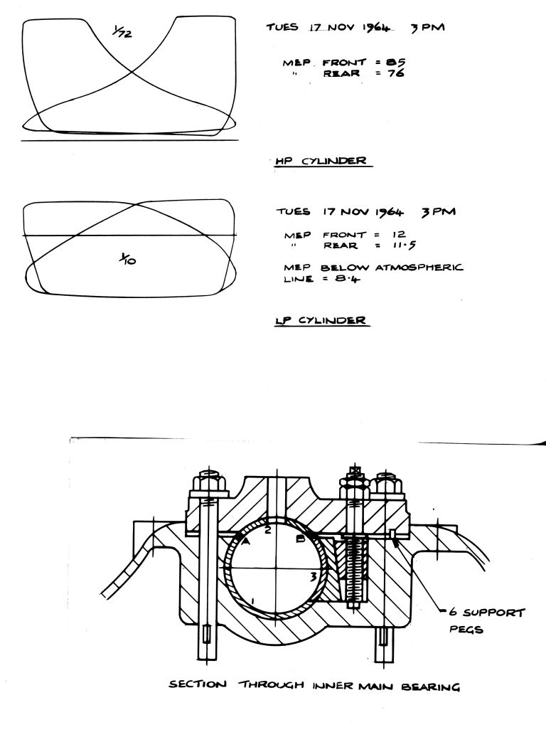

How were split bearings on old steam engines (late 18th - early 19th century) adjusted. I mean the type made for crankshafts etc. not the type adjusted using a cotter and wedge.
Presumably the outer cast iron shell would be made undersize so it could be closed up to accommodate bearing wear, otherwise you would have to replace the brasses every time they wore.
Did they use shims or would they have used something malleable like soft lead sheet? Or something else like thin wedges?

I think this is the one that is most likely to be right:
The method for side to side adjustment is as used on Tubal Cain's Lady Stephanie. He doesn't use the up/down adjustment.
I haven't come across any (many?) models with the more complex block shape, but it's tempting to go this way instead of the usual split on centre line you see in most models.

I note it says: "[to prevent the upper brass from clamping down on the journal when the cap-bolts are tightened, filler sheets to the thickness of the saw cut have to be placed between the two brasses; these can be partially removed to allow for wear]"
so shims should be used, but on the brasses themselves not the housing.

The Pollit & Wigzell has a bearing split into three sections and seperated by wood shims at points A & B.
My model of Agnes has a similar setup.
Phil
