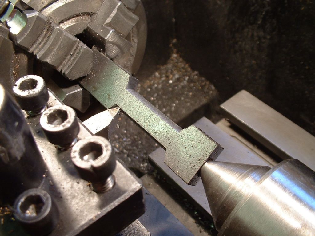

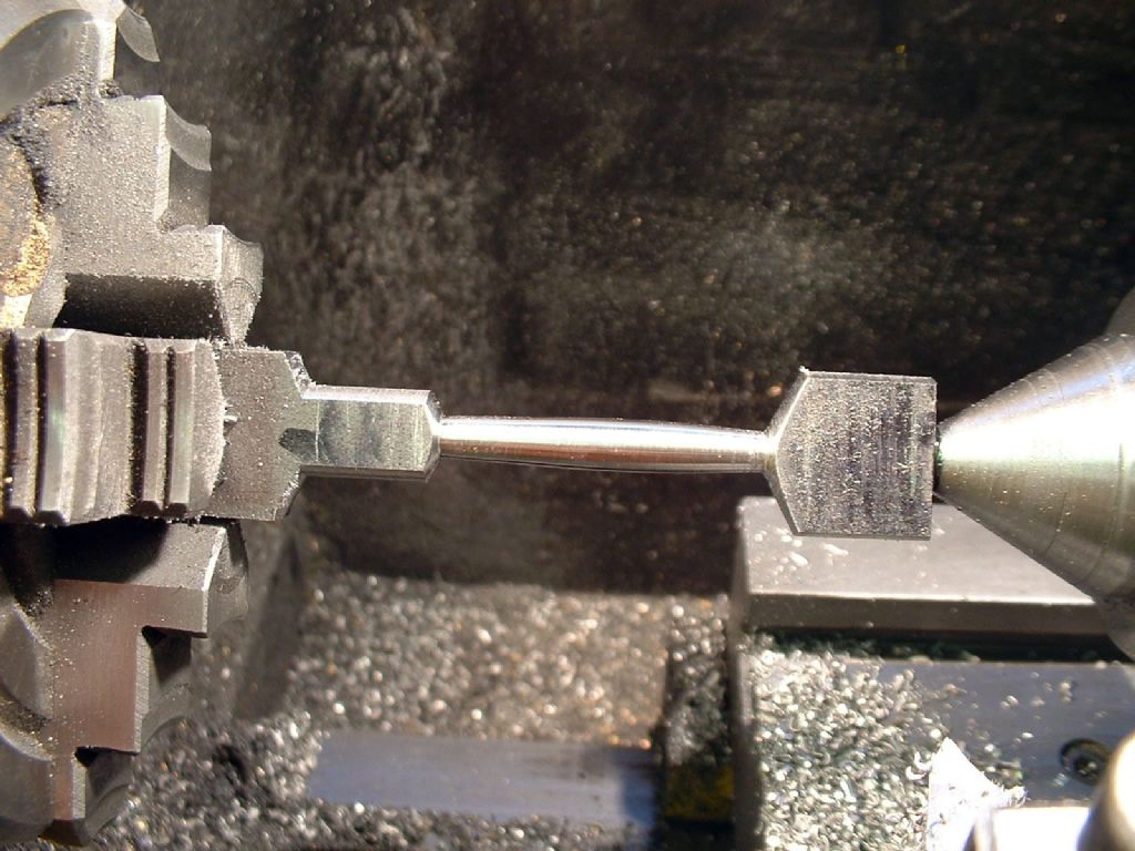

Neil Wyatt07/10/2017 16:13:53
avatar
19226 forum posts
749 photos
86 articles
As Jason has pointed out, if you copy the 300 radius you need to copy the sharp corners to be true to the design
I would ask the original designer how HE did it!
Anything other than blending some taper cuts seems OTT.
I'm sure that's how I did this one...
