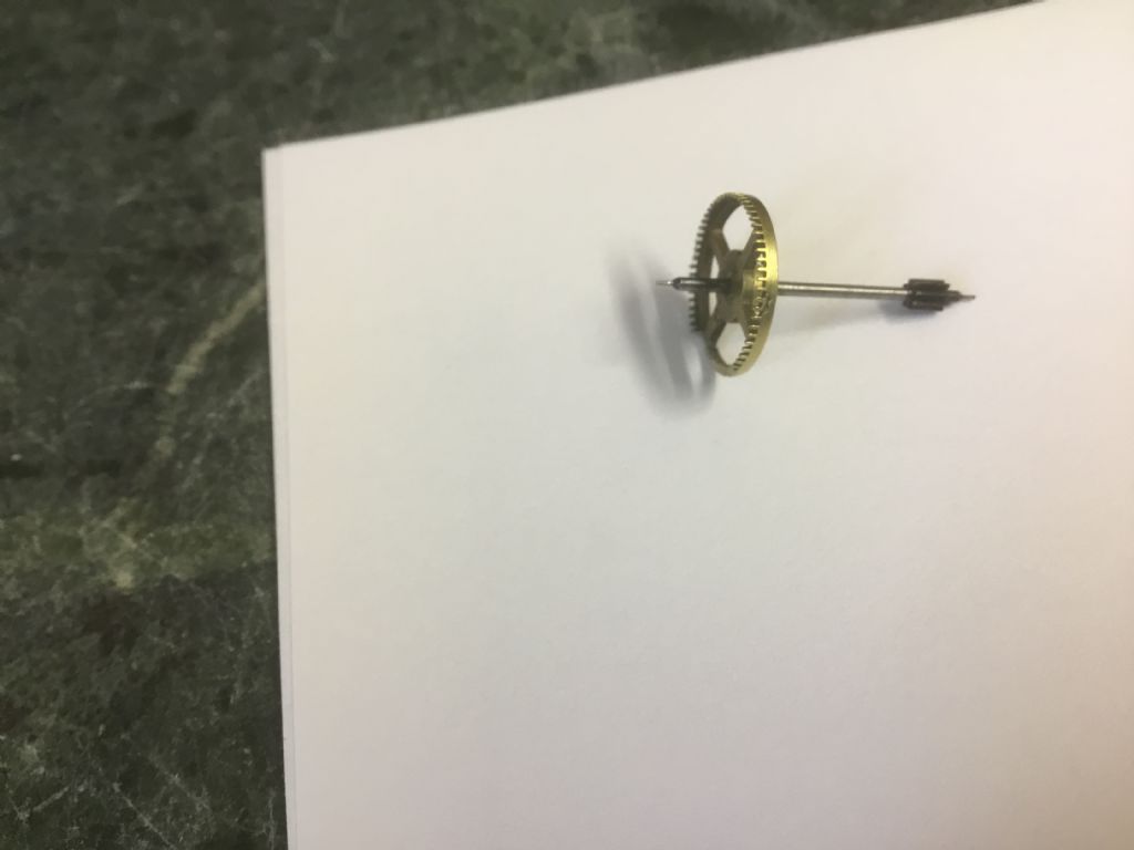

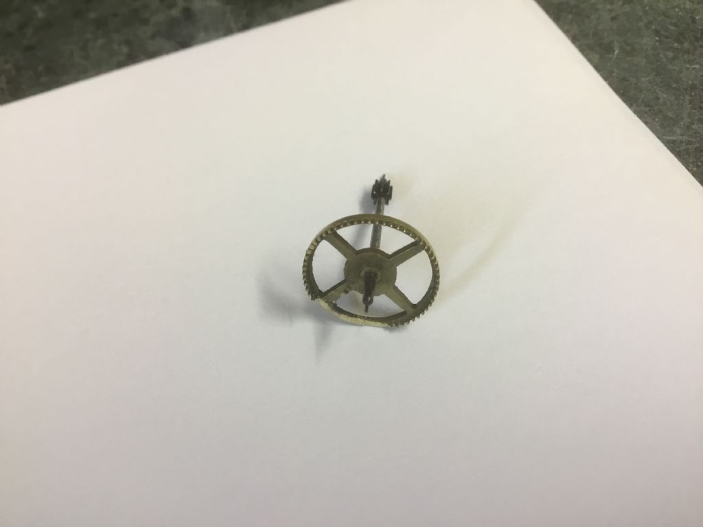

Would anyone be able to help me. I have a carriage clock which has a contrate wheel that has had several teeth replaced over the years and is now beyond repair.
I have emailed several wheel cutters and even sent the wheel to some but they all say the same thing, the wheel is too small for them to be able to cut.
Does anyone know of anybody that could cut a smaller than normal contrate wheel?
Thanks in advance for your replies.

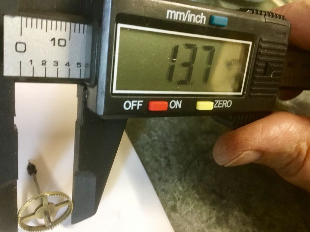

What size is the wheel and how many teeth?
Cheryl Balderson02/08/2017 14:35:41
7 forum posts
4 photos
Hi
There is a fairly big section of teeth missing but it looks to be 60 teeth and the wheel measures 13.7mm.
Thank you
Cheryl

If you post a picture with something to give it a sense of scale then the folks in here may find it easier

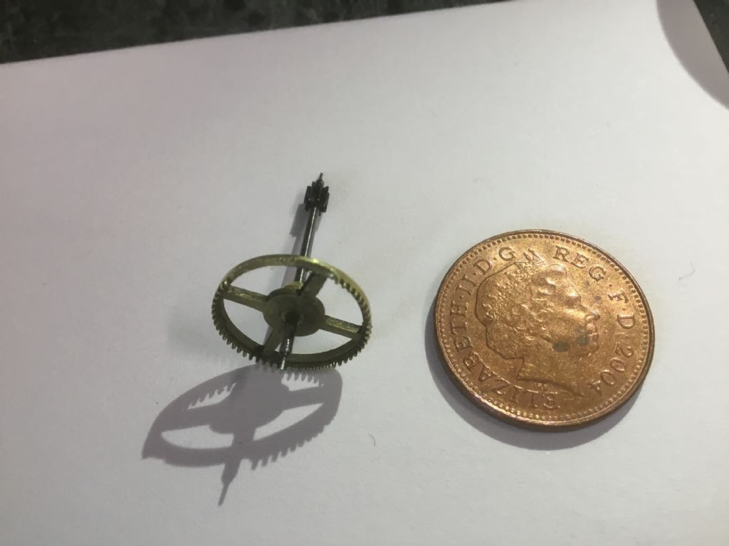

Cheryl Balderson02/08/2017 16:16:13
7 forum posts
4 photos
The bottom picture is compared to a penny

not done it yet04/08/2017 09:36:51
7517 forum posts
20 photos
Cheryl,
There is a u-toob video by 'the village clockmaker' showing him making a similar peg spacing.
https://m.youtube.com/results?q=village%20clockmaker%20contrate%20wheel&sm=3
So it can be done. Perhaps enquire to a proper clock or watch maker if the clock is worth the ivestment. There is a watchmaker in Stamford, who would almost certainly do it for a price - but likely insanely expensive. I have not used their services, but am told their watches are very pricey!
I make things for tractors rather than this scale.
AJS04/08/2017 12:11:20
37 forum posts
Cheryl,
Could try J Malcolm Wild for the replacement contrate wheel.
A search will find his website.
Alan
