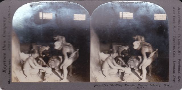

Here's how it's done (late 19th early 20th C) Japanese style(bronze actually).
