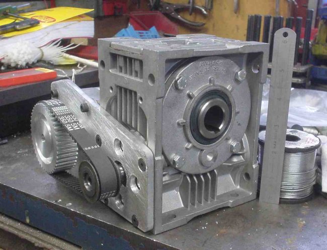

John Stevenson14/11/2016 15:41:47
avatar
5068 forum posts
3 photos
Mark,
How about starting off with an off the shelf electric motor gearbox such as this one.
Ignore the fact it's stepper driven this is for a hobbing machine.
These boxes can be bought for far less than a set of castings and you get a bronze worm wheel, hardened worm, 4 bearings and all in a sealed and lubricated box.
They come in all sizes from about 3" square upwards and all different ratio's.
Ebay Link
This is only 30:1 but a look round will find others

John, interesting idea ,i`ll keep an eye out , don`t fancy ordering from china though.How would you put a spindle in there?
