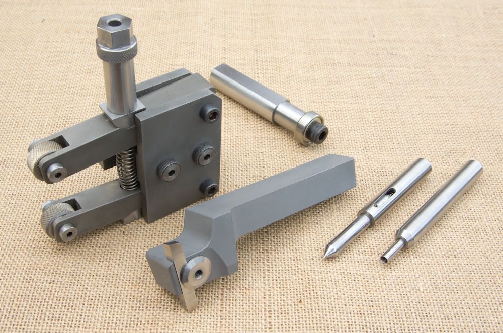

I've just come in from the workshop where I tried making a couple of small thumbscrews in brass - 9mm od.
I turned the outside diameter and applied the medium diamond knurl using a proprietary clamp type knurling tool. The first thumbscrew knurl was pretty good, so I finished the screw and parted off.
When applying the knurl to the second screw ( making sure that the diameters were the same within 0.01mm, without altering the setting of the knurling tool and using the same speed of 150 rpm ), the knurl as terrible. I did clean the knurling wheels between screws but I didn't use any lubricant either time - maybe I should have ?
I notice that the knurling wheels don't line up - the top arm as skewed relative to the bottom arm by about 1/2 a knurling wheels width and the fit between the pivots and the arms seem very loose.
Any thoughts ?

I bought a knurling tool and had the same problem, very wobbly arms.
I made my own in the end which works fine.

These are a photo's of 2 designs in my main album. Th best one by far has plates on the side as per Vic's.
There are some none clamp on types about that will work well but they may bend small parts.

I made the 'tom's techniques' knurling tool as a beginner project. Nice and rigid.

I don't buy the need for rigidity, this is my scrappy knurling tool and it does a first class job every time (including the brass knob in the photo and the aluminium parts in the image below).

I think what Neil has benefited from is not the rigidity of the tool but the pressure that a clamp allows for. I've always followed the wisdom that one needs to traverse along the knurl then back it up to cut properly?

Neils scrappy little tool with its near triangular arm layout and short, central, clamp adjustment screw is inherently much stiffer than the more common design with relatively long arms. Disadvantage of Neils version is the relatively linited diameter capacity and the unbalanced forces due to the cutting points of the knurls not being directly opposite and on the centre line of the workpiece. Most clamp type designs go to inordinate lengths to put the knurls on a common diameter line through the centre of the work considering that perfectly opposed positioning is far more important than rigidity in line with the work axis. The inevitably long arms require the knurls to divine their support at considerable distance so along axis flexibility is built in. Large sideplates being, in my view, a desperate attempt to cover-up unsound design. I acquired a truely massive Marlco made knurler of this style with my P&W lathe. It flexes!
Given that pretty much every writer on the subject sees fit to mention the high forces required by conventional knurls its surprising how accepted less than rigid tools are.
The Graham Meek design in Johns picture is elegant but shows that even the masters among us can have an off day as inherent rigidity is conspicuous by its absence. Making one well enough to work reliably needs a high level of skill, which John clearly has.

The aluminium ones are about 1 1/2 knurls wide, the brass one was cut from a long bar knurled for about 2" and chopped into a set of nuts..
I always get the knurl running, but not cutting, then rapidly apply enough pressure to get it stared positively, then increase the pressure until I get a sharp knurl. yes capacity is limited but there is SOME play in the setup. I think that as long as the pressure is applied straight on, once cutting the embryo knurls themselves help keep everything straight.
I think the main issue is why have a complex way of applying huge pressure when even the tiddly M4 screw, working at a ~1:2 mechanical disadvantage in mine is adequate? If I was making it again, I would go bigger, but as I used bronze spindles and washers for the knurls to run on (it isn't quite as skanky as it looks in the detail) it shows no signs of giving up.
Elsewhere I have show a 2 1/4" straight knurl cut in EN1a using the 'plunge in method' so I have a feeling the 'small lathes can't take the forces of an unbalanced knurl' claim is a myth as well.

When I was in the apprentice training school in 1974, the machines were much larger than those in the usual home workshop. The standard issue knurling tool was the rotating disc with three sets of knurls, just pushed into the job with the cross-slide.
Although I have a reasonable size lathe - a Warco VS1224 12" swing - I went for the clamping type knurling tool as I thought it should be best since, as we all agree, the forces are contained within the tool rather than being transferred to the machine.
When knurling, I firstly set the clamping screw to make the knurls touch the diameter and for them to start rotating without making much of a mark. I withdrew the cross-slide and added a bit more to the clamp screw then fed in the cross-slid again taking the knurls just over centre.
As I said, the first knurl I did was really good, but adopting the same process on the second part left me with a knurl with the peaks broken away and the knurls covered with the remnants.
I took in posters suggestions on knurling speed, maybe I was over-egging it bit at 150 rpm. Maybe too much depth of knurl, maybe feeding in the cross-slide does something to the geometry of the knurl and causes it to break up, or, maybe a combination of all those things ?
I have a much smaller Soba knurling tool as well - I'll try that when I get in the workshop again - it's much more rigid side-to-side than the one I used this time. There must be some logic somewhere in getting a good knurl !
