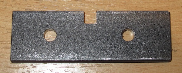

A *raw* beginner milling question (so be gentle)....
I used my new milling machine (SIEG X2P) for the first time this evening, basically to cut a 6mm slot 6mm deep in a piece of 4mm thick mild steel.
Being cautious, I feel that I "nibbled" at it with the 6mm end mill, and took too many passes to reach the depth of the slot. How deep a pass would be "sensible"? (i.e. how many passes?)

?how do you cut 6mm deep in a 4mm bar ?
It's usually easier to cut slots with slot drills rather than endmills unless you want a slot open at one end. Endmills as you have probably found will not bore a hole as the cutting face does not include the middle third of the end.
Edited By Frances IoM on 05/05/2016 23:05:49
Rod Neep05/05/2016 23:11:29
avatar
59 forum posts
Posted by Frances IoM on 05/05/2016 23:05:24:
Well, I managed to. See the photo above.
Frances,
I think the picture that Rod posted answers that ^^^

Well..... I compromised, still being cautious, and took 1mm cuts on the second one I needed to make. The machine and the cutter didn't complain, and the revs stayed consistent on the display.
One thing which I noticed, is that on the "exit" side, there was a pretty large noticeable burr on the edge of the steel.
Thanks for your help folks. Much appreciated. Maybe I will be a little more brave next time I need to do a similar task, and take 2mm cuts.

A simple rule of thumb when using the full width of the cutter is 1/4 of the diameter so 4 passes of 1.5mm, use that as a starting point and go up or down depending on the machine. One other thing to watch if you were using a 4-flute end mill is that the more it has to remove in one pass the more the cutting action will pull it to one side so you could end up with a slot wider than 6mm.
Feed rate wise again don't tickle it, about one turn of teh handwheel per second would be a reasonable starting point

On the vertical mill I'd cut the slot in two or three passes with a 6mm cutter. On the horizontal mill straight through in one pass.
With these small cuts you are unlikely to be power limited, even on a small mill. I'd concur with JasonB; the biggest mistake is pussyfooting around with feedrates. Slower isn't better, it just rubs the cutter and squeals or chatters.

And I am quite capable of cutting and filing a 6 x 6mm slot in the edge of that metal, especially as there was no need for fine tolerances in this case, as it is a clearance slot. (A pair of clamping plates).
But I have a new toy! And I wanted to use it. cheeky
