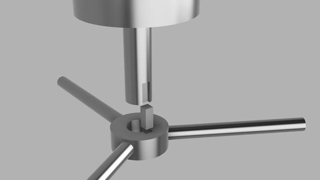

I need to cut a keyway through a 19mm diameter bore, and depth of 24mm in EN1A.
I’m thinking of buying the below 1 Tonne Arbor Press from chronos , together with a 6mm broach and associated kit from Keaton.
http://www.chronos.ltd.uk/acatalog/info_SMA1252.html
Before I spend any money I’d be grateful if anyone has enough experience to confirm what I plan will (or will not work) ?
Thanks
David

Not going to work.
The 6mm broach from ARC is 300mm long but the press only has 150mm of daylight.
Even the 3 tonne version of this type of press only has 280mm of daylight.
Sorry but you need a broaching type press as opossed to an arbor press.

That doesn’t bode well for my original idea – but at least I’ve found out before spending money!

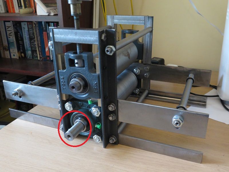

It’s for attaching the handle to the shaft of a printing press I’m making for my wife (see fusion 360 mock up below). If anyone else can think of a way of attaching the handle, or cutting a keyway I’d be very grateful for input.
The hydraulic press would no doubt work – but it’s a lot of money to spend for a one off.
David

I have a 1 Tonne arbor press and have no problems broaching metal of any size, You just need to remember to graduate the cut with bigger sizes, the same way a gun barrel was traditionally rifled by shimming the height of the cutter (albeit in a more complex mechanism).
Often times i use the arbor press to get it started square to the barrel with the appropriate collar, and if i run out of room i place the workpiece in a vice and finish the cut with a hammer, its pretty safe and it works so long as you don't hit like a madman but please dont take that as the gospel.
Ps. I see the image of the work piece you have kindly loaded, I can see why you would want to keyway that, may i recommend that you actually make that whole shaft square? You either file or broach the female part square and it would absolutely hold fast, it's a bit more difficult but the choice you go with will probably be the most sensible one and easier route of broaching a round shaft.
Michael W

Making the shaft square is not a bad idea at all – my one reluctance is that the shaft and roller are now all one. Welding it together, and then turning it to size has taken so long I’m keen to avoid touching it as much as possible (making a mistake and having to start again would hurt!). I figured that cutting a keyway in the handle might be easier – but maybe not.

Depending on the torque being applied is there any merit in cross pinning the handle to the shaft. Maybe a taper pin turned flush to the bush.

Could you get away with a semicircular top on your key and just mill down the handle?
The facetious option is a cheap 5 ton bottle jack and press upwards using the underside of a parked lorry to press against....

How much force is likely to be needed to pass paper through the press? I would have thought a 3mm keyway would do, you could always use two on opposite sides if needed.
I have pressed 1/8" broaches through with mu drill press, larger ones make friends with someone who owns a hydralic press.
I have also planed 3/16" keyways through 1" thick steel on the lathe, time consuming but easy enough, see below

Martin's cross-pinning sounds good [except perhaps for your choice of three spokes]
Alternatives:
  1. Woodruff key [only requires broaching the hub, not the shaft]
  2. Substitute a cylindrical key [i.e. a dowel], which might usefully be threaded
Note: (2) works for Myford ... see fourth picture here
Edited By Michael Gilligan on 27/03/2016 18:41:29

If a 3mm keyway would do, then life would be easier. The machine mart arbour press has a height of 138mm – and Keatons keyway broach for 3mm is 128mm.

Drill half and half into shaft and handle boss (on the joint line) This assumes that the two are a good fit and tap 6mm, screw in socket grub screw, job done Any slack in the fit and this method is not likely to work as you will not be able to tap the hole. No need to go right through 12/13mm deep should be enough.

For a one off, small part like your example, why not just file the keyway? Takes less time than reading these answers.

Round keys used to be common. Put your hub on the shaft. Drill a hole and ream to size. Use a dowel pin or piece of rod as the key. My South Bend 10K lathe has a round key on the crossfeed crank.
The hole should be centered on the OD of the shaft.
