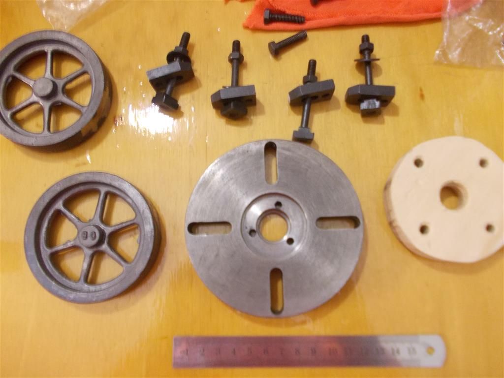

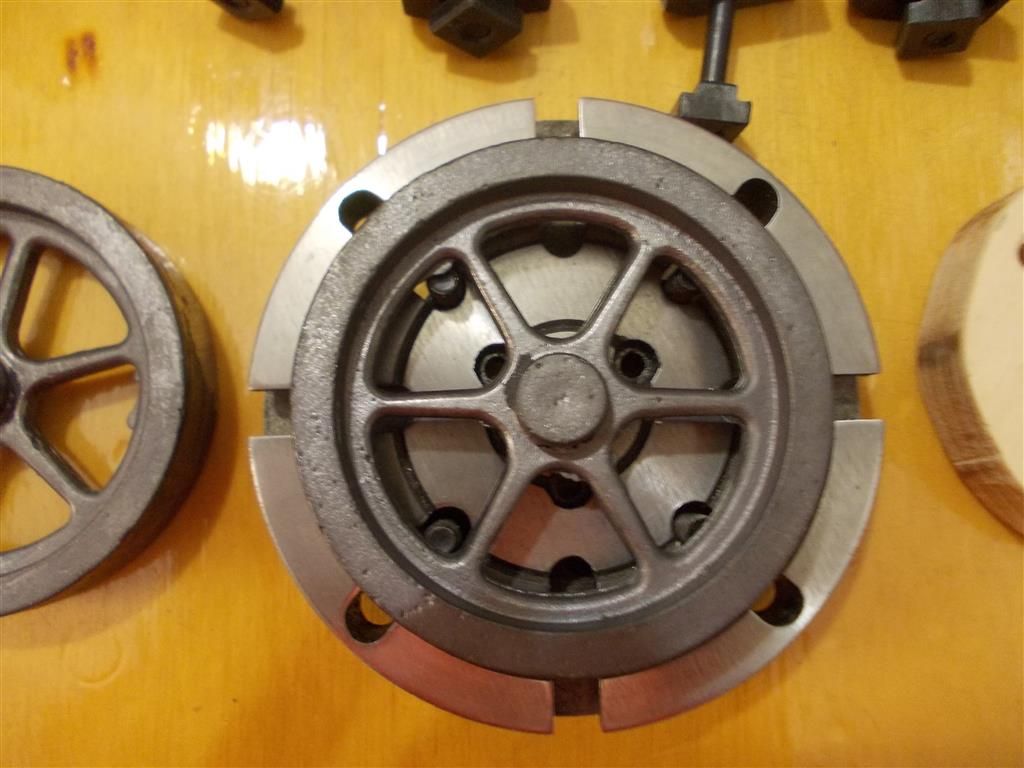

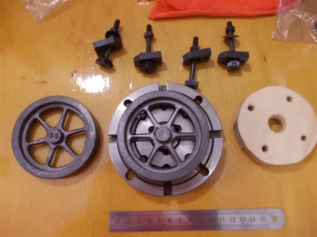

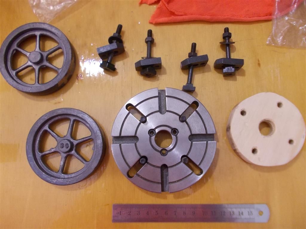

I have cleaned up the cast iron flywheels with the angle grinder today (lots of casting flash) and I am trying to work out how to attach them to the face plate prior to being machined. I have never used the face plate before, having machined all my previous flywheels using a steel mandrel. I cannot work out how to bolt the flywheels to the face plate ; the flywheels do not seem quite big enough to get the bolts through any of the provided slots and holes.
I may have to use the face plate to get the centre holes drilled and then switch over to a mandrel to finish machining the edges and outer surfaces. I am hoping not to have to do that : I have found cast iron  to be more difficult to machine with a mandrel then brass or aluminium as it vibrates a lot more causing chatter.

One way of holding the flywheel would be to screw a piece of MDF which is larger than the flywheel diameter to the faceplate. Make a central hole to clear the boss if it protrudes beyond the height of the rim. Use 3 bridge clamps over pairs of spokes screwed into the MDF. Before the clamps are tight, juggle the casting so that the inside of the rim runs as true as possible then tighten up for machining.
Now you will be able to machine the edge and one side of the rim, and clean up the boss and make the central hole. After that, you can hold the wheel on your mandrel or in the 4 jaw chuck to clean up the other side of the rim and finish off the boss.

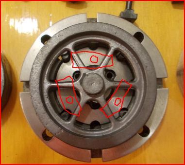

Another option would be to drill and tap some additional holes in the faceplate to suit your clamp threads. Then just span across two spokes with a clamping plate.

1. Okay, I will drill and tap for M5 (tap drill = 4.2mm). What is the face plate likely to be made of and how difficult will it be to drill and tap ?
2. How thick should the timber or MDF board be on which the face plate rests ie. how far from the face plate should the closest edge of the flywheel be ?

1. probaly cast iron so shoud drill & tap OK, mine did.
2. does not need to be much just something to let the tool run out into, 6mm would do.

I,v got 8 full sheets of 3 mm MDF, so I use that, but cardboard, maybe more than 1 layer is quite ok between the FW and the faceplate.

Be careful that you don't overtighten the clamps as to much will break the spokes.
