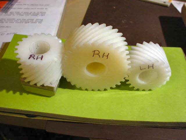

Does anyone know where I can get a pair of worm and wheel gears for this sort of arrangement? The reduction ratio needs to be 2:1 (i.e. for a 4 stroke engine) and the diameter of the crank shaft will be of the order 10mm to 12mm ? I’ve spent a while trying to find them on Google, but haven’t managed to come up with anything yet.

A worm and wheel cannot give such a small reduction as 2:1 I think what you are looking for are skew gears. (Also called helical gears.)

Ah - yes. This image is on wikipedia for helical gears. The lower section is exactly what I'm after. Are they difficult to cut? (I'll have a look in my copy of Ivan Laws book this evening!).

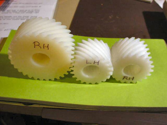

Correct they are called skew gears which are just helicals with the same hand.
Normally helicals operating in the same plane need to be opposite hand but if mounted in the a 90 degree plane they need to be same hand.
Normal plane.
Opposite plane.

If I want a 2:1 ratio between the crank and cam shaft, and I look at helical gears on hpcgears.com the diameter of the large gear (I’d use this for the cam shaft) is twice that of the small gear(Id use this for the crank shaft). Since PD = N/DP that seems fair enough. But, when I look at the photos like the image of a Find Hansen engine at the top of this thread, the two gears look either the same size or the opposite way round to what I was expecting ?

It depends on the helix angle. For helical gears, if you want a right angle drive then the helix angles just have to add up to 90 degrees. The pitch diameter of a helical gear is given by N divided by (DP x Cos(A)) where N is the number of teeth, DP is the Diametrical Pitch and A is the helix angle. For 45 degree helix angles Cos (A) =1 so the relative diameters depend soley on the number of teeth - 36 teeth will be twice the diameter of an 18 tooth. If you choose 26.6 degrees and 63.4 degrees for the 2 helix angles then you end up with 2:1 gears that have the same OD - which is what the Wyvern uses:

You can see the angle on this Domestic that I made, the shallow angle on the crank gear lets it be larger than the cam gear where you would normally find the opposite with spur gears. This allows the larger dia crank to pass through without such a thin wall as in Rod's photo
Better shot where you can see the helix of both gears

Thanks everyone. The missing part of my understanding was the cos(A) in the formula

If we are picking holes in this then cos(45) does not equal 1, Tan(45) equals 1 and cos(45) is 0.707 (square root of 2).

Further to this 2:1 ratio in similar sized diameters for skew gears:
The angles in the example above are found from the inverse tan of 0.5 and 2 (half the speed one way and double the speed the other).
Tan(63.435)=2
Tan(26.565)=0.5
The angles have been rounded to 3 significant decimals. If they are rounded to 1 decimal you get the angles stated earlier.

Pick holes we must - got to get it right. The point I should have been trying to make was that with both gears at 45 degrees you use the same divisor, so that the relative diameters stay in proportion to the teeth number.
