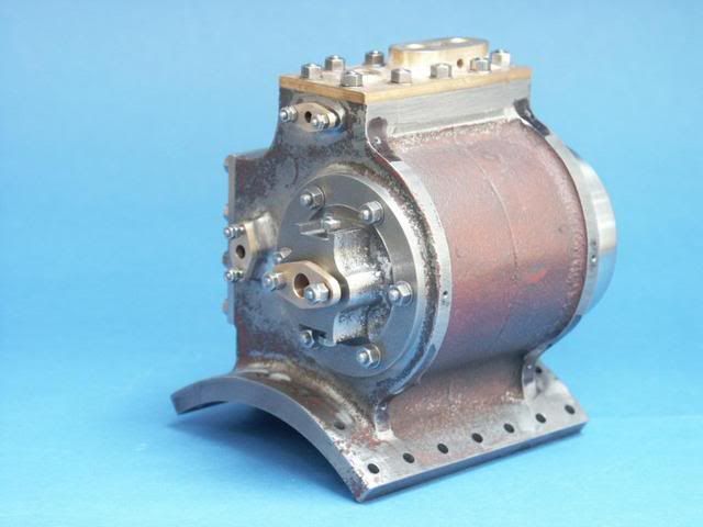

JasonB | 25/01/2016 19:14:33 |
![]() 25215 forum posts 3105 photos 1 articles | Only a TE cylinder casting, nothing special and they were only 6 of the 63 tapped holes in that part and on a curved surface just to make it interesting. They are the cleading retaining screws on the two flanges. I've not threaded the lathe but have put a few M3 and M5 threads into the mill and it was quite nice stuff, obviously the chinese melt down quality scrap metal |
