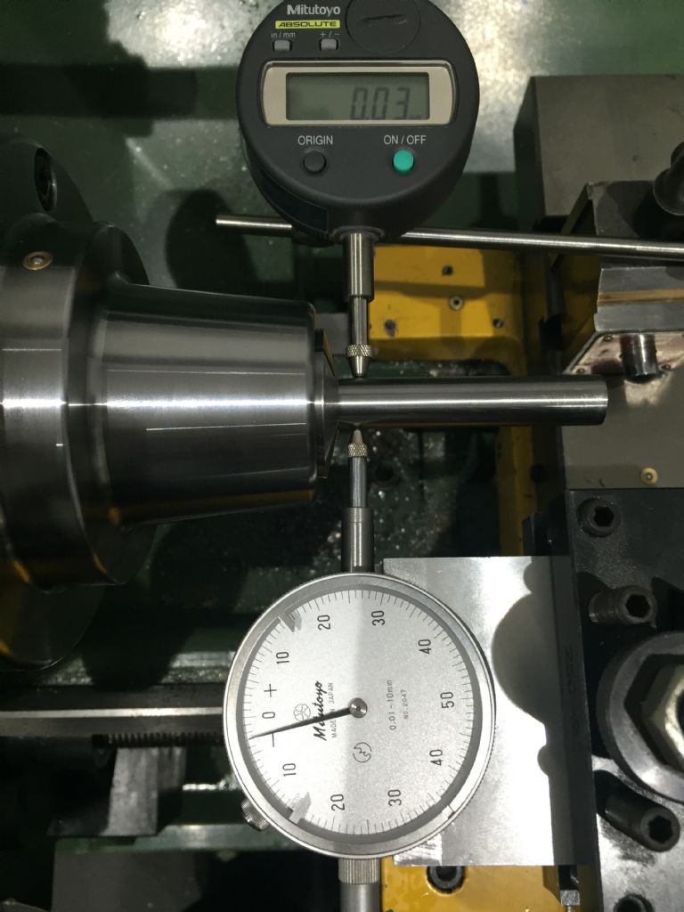

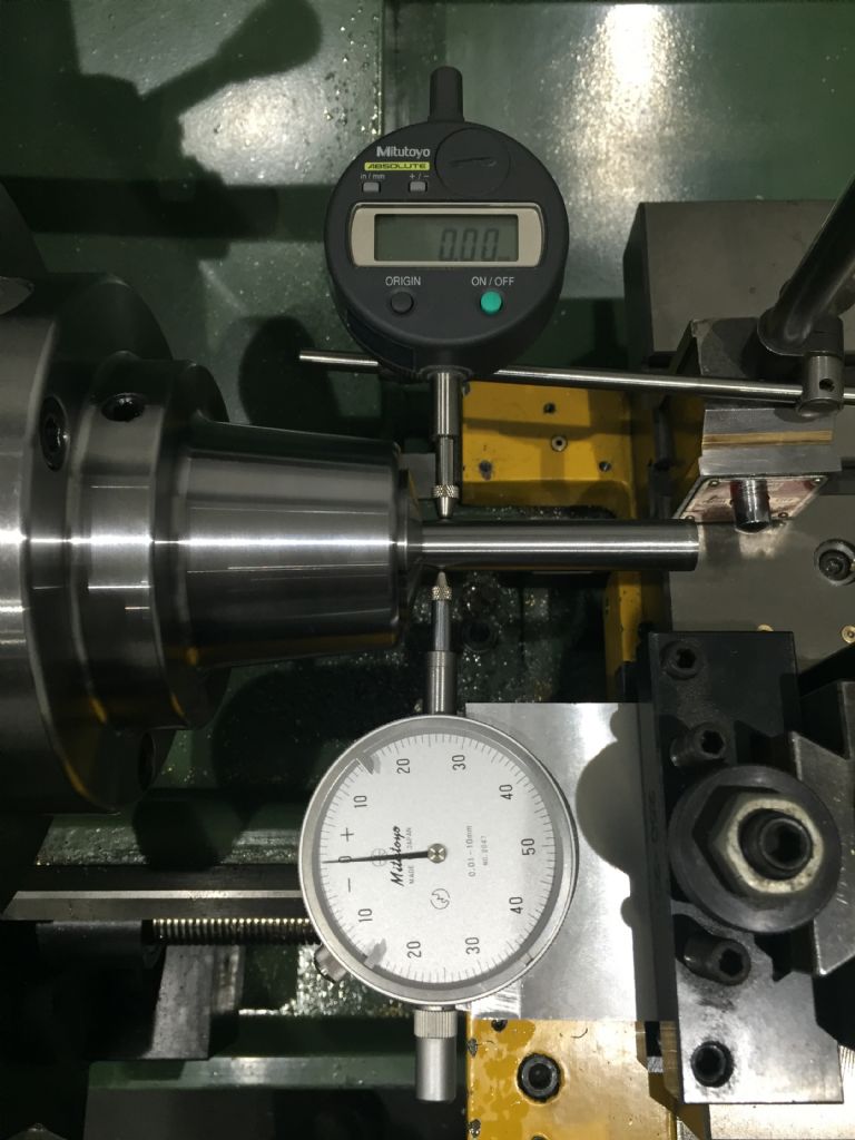

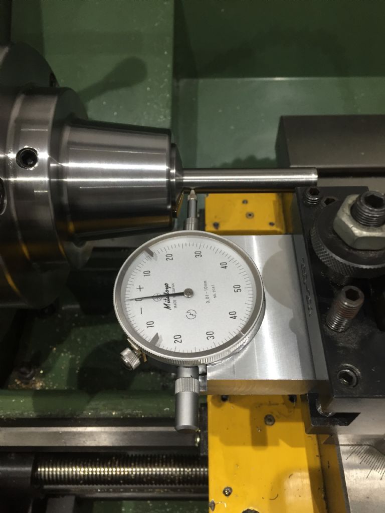

Hello all,
As some of you may have seen on another thread of mine i have been planning some upgrades to my BH600 lathe. One of which is a 5C collet chuck, i have machined up a back plate and fitted the chuck however i am struggling to get it to fully 0. Initially i machined the back plate to be a shrink fit but it was more like a light press fit to be honest. For a first attempt thought i was happy with the fit. Once i had it snuggly on the backplate i drilled and tapped the 3 holes on my milling machine so i could guarantee a accurate fit. once everything was tight i installed the chuck on my lathe. (For those not familiar with this lathe the back plate screws on and is not on a cam system) Happy with everything i decided to check the run out. I only have imperial collets because at the time i thought it could do both imperial and metric like an ER collet but after reading an interesting thread on hear turns out they can't. Any way i purchased some 1/2" silver steel to use as a test bar as i don't have any pin gauges. Initially the run out was around 0.5mm!! Which for a collet chuck is way to much, i persevered and turned the back plate down so there was some movement and got it down to under 0.1mm run out, better but still not great. After some bashing around with a copper and hyde hammer i had it almost there but something still wasn't right. My battle initially was knowing what part of my equipment to trust? Was my clock out? If the bar bent? Is it my lathe? So today i have been having a play. A few people suggester that the way the DTI was mounted may be causing some fluctuation and the stand wasn't great as it had that adjustable bar in it so a solid bar would be better.
So what have i don't today well i have cleaned the back of the collet chuck, i have cleaned the back plate cleaned the silver steel, cleaned the collets the lot! Then i went about machining up a tool post mounted DTI holder, i ditched my cheap axminster lever DTI and machine a holder up to take my Mititoyo 0.01 plunger DTI all installed and working i made sure i went belt and braces and set the clock to band on centre, clamped the beds up as tight as i dare and locked the DTI on 0 that way i knew everything had no movement no play nothing, what ever the DTI was reading i knew it was on the bar. Might be worth mentioning i am fortunate enough that my workshop is fully insulated and remains at 20deg all the time so i know that the metal is all at room temperature as well. Quick spin on the chuck and i am getting a repeatable 0.03... Happy that its reputable but after all that effort its still out crying 2
Sorry for the ramble but i thought i would give you background so you know that i haven't just put a chuck on and expected perfection. My goal tomorrow is to get an imperial pin gauge so i can guarantee the accuracy. I would have thought silver steel is accurate enough? 1/2" Silver steel should be ground to +/- 0.015mm which is much finer tolerance that my DTI can read but thats not to say my piece isn't bent or out of tolerance for some reason? Failing that is the only solution using a hammer and keep chasing the chuck around until it zeros or is 0.03 good enough?
Thank you all for taking the time to read this, hope you can help.
Steve

I can see no problem with the measuring setup shown in your pictures.
What you need to do initially is eliminate the collet and silver steel. Move the DTI plunger so that it contacts the inside conical surface that the collet fits into. With the DTIs shown you will only be able to pick up near the open end of the taper bore but that surface should show no discernable run-out on your 0.01mm indicator.
If that runs true then you need to check each collet
Ian P

Is it me or does that collet look like its sitting a bit far out of the chuck, mine all tend to fit back near enough flush with the end of the chuck nose.

Cheers for the reply Ian, I do have a lever DTI again 0.01 but its a cheap axminster one, not that theres anything wrong with that but it seems to flicker about a lot, not as smooth as my Mitutoyo clock. I will try it again tomorrow on a more solid Eclipse base and measure the runout in the nose of the chuck. Is there any particular point to measure on as its a taper?

Thats as far back as that particular collet goes Jason, I will have to check the others? I assumed that was normal? Its a Warco collet chuck and the collets were from RDG.... Not sure if that makes a difference.

You may also be chasing something you can't get. A standard Hardinge 5C will run 0.025mm or better so assuming you are using cheaper 5Cs you are not going to get better. Even special accuracy Hardinge will only give 0.005mm so don't expect zero.

With a tapered hole there is no 'one place' that will give the result, you have to test in several places. You will soon know if the collet seating surface is not true.
The next issue is how to correct any error. If the collet fixture can be removed and replaced in the same position every time then my money would be on re-surfacing the cone with a toolpost grinder. (Dremel or whatever and patience.)
The finger DTI even if not the best will still give you a good ide of the concentricity
The Mitutoyo, which one as you show two?
Ian P

I bought the same collets from RDG and not a single one of them has a runout of more than 0.01, some don't even register on the clock. My chuck however is a Bison one, it came with the back plate fitted, stuck it on the lathe and literally no run out. My collets are pretty much flush with the end of the chuck too.
I would clock everything in sequence. DTI the lathe spindle nose, if ok, Remove the chuck from the backplate, DTI the backplate, if ok, install the chuck, DTI the ground part on inside of chuck, if ok, then it's your collets.

I have a 5C collet chuck that I purchased from Chester some years ago and found it to be quite accurate i.e. a bit better than my 3 jaw chucks but not up to the standard I expected. However I noticed that Bison 5C collet chucks have a means of finely adjusting the collet to get absolute concentricity - at a price! It works a bit like a Gritru chuck.
I therefore bought an Adjustable Backplate kit from Hemmingway which gave me the same fine adjustment for only £17.70 and a mornings work. Result - brilliant I can get any collet to run perfectly. If anyone follows this course of action I recommend that 4 fine adjustment screws are used instead of the 3 stated in the instructions as this make adjustment much easier (the same technique as centring things in a normal 4 jaw)
