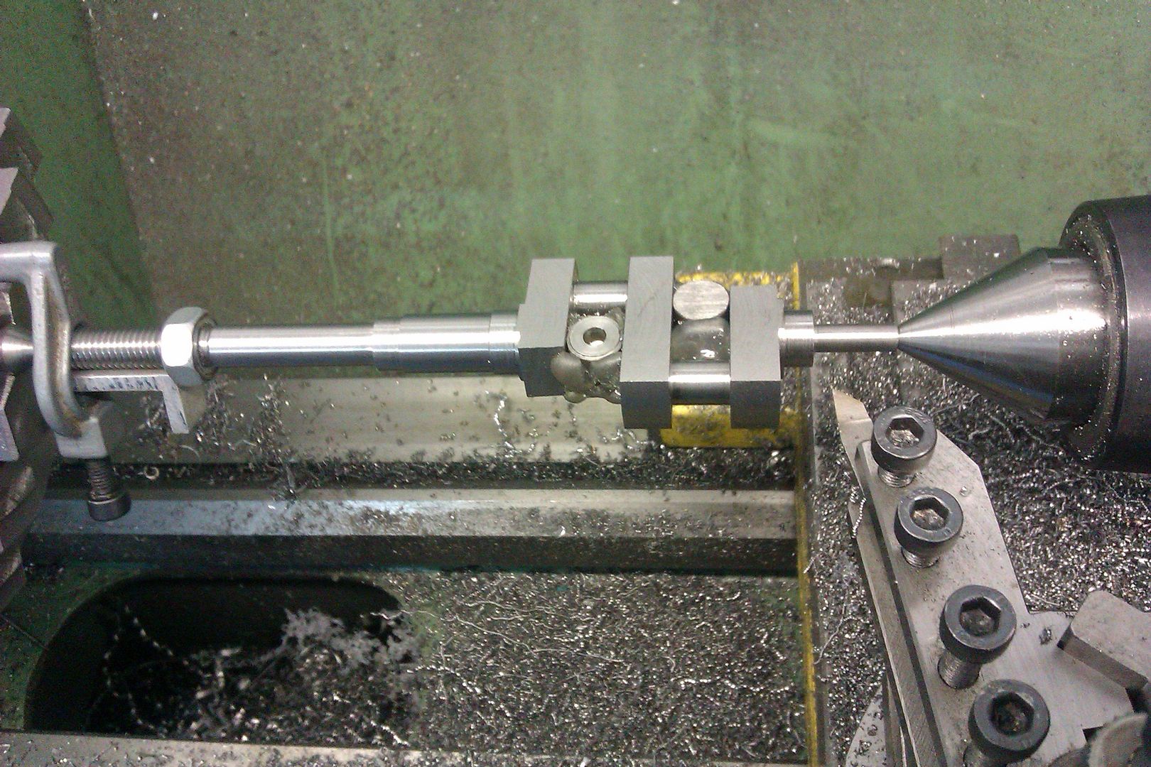

I have just (between Christmas and the new year) turned a dumb-bell test bar between centres. The reason was to have a bar purely for setting the tailstock correctly and also to play around with a vertical shear tool. It also allowed me to use a newly acquired centre for the lathe headstock. After centre drilling I used a rusty old piece of steel about Ø25mm turned down the ends and centre sections to about Ø22mm with a carbide tipped tool (rough finish on this unknown steel). This left two 15mm bands for the fine machining. I cleaned these off with an ordinary HSS tool then used a HSS vertical shear tool to give a very fine finish. Measured the diameter difference of the test bands, adjusted the tailstock set over and repeated until the bands were about the same diameter. The biggest problem was adjusting the tailstock with worn slot ended grub screws. I have ordered some hex grub screw replacements (Colchester lathe spares!) to make it easier. I found that tightening the barrel clamp had to be done to the same point each time and the clamping of the tailstock to the bed was also able to change things noticeably. I found the best way to get the screws for set over adjusted was to calculate the adjustment required (half the difference on the test bands) as a degrees of turn for the screws and try to move them this amount.
I ended up with two test bands that are within 0.005mm of each other and a very smooth finish. I stopped at this point as I think that will do for what I want. I suspect the vertical shear tool or some fine abrasive will take off the difference if I wanted it better but this was an exercise in setting the tailstock more than anything else and the slot head screws made fine adjustment hard.
For the vertical shear tool machining was done at 400rpm 0.005mm per rev feed. I held a 1" paintbrush against the band when cutting, with suds applied to the bristles as required, This gave a thin film of cutting fluid and at the same time collected any fine particles that were being carried around the band. When the band was done each time there was a layer of very fine metal dust gathered on the brush looking like a silvery paste.
Martin

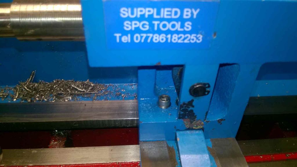

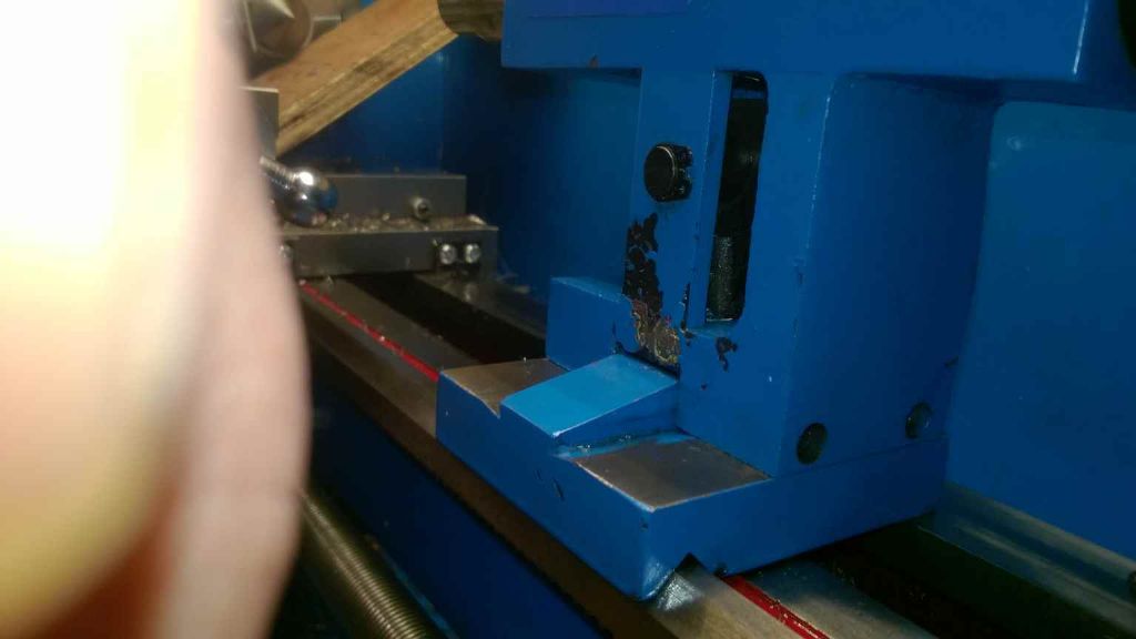

Tailstock adjustment
This is what my tailstock looks like
The M5 bolt you see is not original. The original design requires that you pretty much have to take the tailstock off to tighten it up once you've got it set up. Needless to say, this is an excellent way of knocking it out of adjustment.
The basic approach is to leave the tailstock lightly tightened to the base and tappy tap until it's spot on then tighten it up. My skills with tappy tap seem restricted and getting the adjustment within .05mm is about as good as I can manage. Most often tightening the bolt slips it that far out again if with access from the top.
In the rear there are two grub screws which adjust the alignment. I'm not entirely sure how they are supposed to work since they are bearing on to flat surfaces. They do a bit. However, even with the nearer screw tightened pretty hard the tail stock is still at an angle (towards me as it moves from the tailstock along the barrel. I suspect that adjusting with this tight isn't really helping the ease of adjustment.
So what to do?
I've seen some designs for forward and back tailstock adjusters (e.g. this)- basically a bracket and a stud thread. It would have to go at the back of the tailstock since it will get in the way of the carriage and slides if it were at the front.
My concern with making that is tapping cast iron. when I fixed my lathe I put some grease nipples in the headstock (M6) but had to redrill and tap to M8 because the thread stripped the first time I tried to take the grease gun off.
I expect I will want to use M5 fine for the bolt, so one turn is 0.5mm, (.01mm is 7 degrees - well beyond my aspirations!), however I suspect this is a bit fine for cast iron.
The other question I have is how to get the thread tight in the not so there is little backlash. My tap and die set is pretty poor quality being an anonymous set I picked up years ago. even tapping aluminium has made the M6 tap unusable (and the M5 die has been destroyed tapping the bar that turned my last between centres attempt)!
I'd also appreciate any advice on the angular adjustment. I suspect that adding a jib strip would help, but I think I need to do something more if I want to get the angular adjustment spot on.
All help, pointers and advice gratefully received!

Neil Wyatt23/01/2016 16:15:59
avatar
19226 forum posts
749 photos
86 articles
If you set your tailstock as accurately as you can and the collars on your test bar are both the same distance from the end of the bar, then even with your inaccuracies the bar should come out OK as both collars are turned under exactly the same circumstances. That does assume you take the final cuts at the same setting after trying to get the collars as close as possible. This is how mine came out using this method, as near as my mike will tell me its 0.0003" out.:

Hi, Neil. I'm presuming that what you've done is to turn the bar round in the lathe so you are machining each end with the carriage in the same place?
That's a good idea for a test bar. Now to work out how to get the tailstock spot on ...

Exactly, and it compensates for a degree of tailstock mis-aligment.

Pannal, Damn, bit far out for me, I always forget about that bit of Yorkshire being "North as well!. It sounds toi me like you need to do a bit of work on the tailstock. Yes, it should be high, but maybe a thou or two at most. if you blue the bottom slides up you will probably find some high spots you can relieve with a scraper to get it down a bit, but the centering across the bed needs to be easy to adjust, and as near to spot on as you can get it.

You may find that the blue paint is causing the front of the tailstock to lift slightly

This is my version of Neil's test bar. The end pieces appear to be the same diameter to within the limit of my abilities to measure it (a electronic caliper claiming 0.01 mm resolution).
On my first try I ended up with a noticeable difference despite not moving the cross slide. I put it back in and just re-cut about 4 times each end at quite a slow speed (200rpm?) each time taking the merest sliver off. Is that the right approach? I'm using a carbide knife tool,
MY first go a the collars I did at high speed (<1000rpm and my first run in top on this machine), since I thought this would give a better finish. It really didn't and furthermore the lathe shook somewhat. Is this something which is acceptable? Do I try and balance the spindle and work piece with a dog bolt on the other side? Should I be trying to cut fast?
Anyway. I'm quite pleased with this, though I'm scared that I will go out later in the week, re-measure and find that I was 1mm out in my measurements and it's all rubbish!
