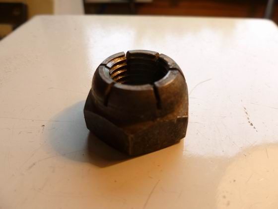

Restoring a motorcycle I've come across a type of locking nut I've not seen before. Usually they use ones that have a spring steel type insert in them and the others on the bike are that type but this one on the swingarm spindle is different with slits on the flats .
Are these classed as a one shot use or are you "allowed" to crush/close up the slitted area so it grips the thread again?, it just spins on and off loosely like a normal nut at the moment.
I would replace it with a nyloc but it's M14x1.25 and I can't find any, no one seems to do any below M14x1.5 fine.

Hi Mick, generally speaking just about any thread locking nut, including Nyloc's, are only designed to be used once and when they are removed should be discarded and new ones fitted.

As a last resort you could put a tube over the end and knock it to close the "petals." Unlike Nyloc they aren't deformed when fitted.
Failing that, if there is enough thread you could add a spring washer to it.

Why not use Locktite? It actually works better than most sorts of lock nuts. It even used to work on my Triumph single.

These nuts are called 'Marsden nuts' and I remember them being used to secure a fluid flywheel to the crankshaft in AEC buses, we used to reuse them after hitting the nut with a hammer squarely to close the petals a bit, all very crude but it worked. Regards Pat

Thanks for the suggestions I'll probably use locking washers AND loctite to make sure. I had thought of expanding the slots to make it a proper castle nut then drilling the spindle to suit but 14mm isn't that big and I don't want to weaken it too much.

We used to use nuts like that , and others that had on the top side an oval hole(squeezed in a bit) for engine fittings on aircraft, Nyloc nut don't do heat too well. For non aircraft stuff it's OK to give it a bit of a whack with a hammer, you can do that with a Nyloc nut(once), although on a critical bolt on a motor bike I would use new, or Loctite.

At this stage there is no thread locking property, I would suggest that the next process is to crush the castleations slightly to give a certain amount of locking, by tightening the threads up.
Zinc plated and sent to the stores.
The nut has now been off several times since it was made in 197? ( I have an identical nut on my 1973 Honda XL too) so the castleations will have deflected back somewhat thereby reducing their pinch on the threads.
Would it not be possible to re crush the castleations by squeezing them up in a 3 jaw chuck , or indeed clobbering them with a hammer until the required amount of pinch is acheived.
