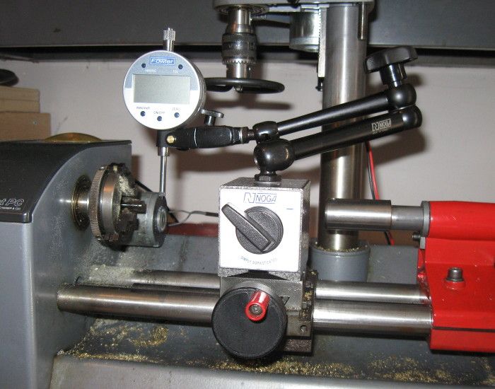

I was fortunate find an almost brand new Noga DG61003 at a very reasonable price on a garage sale last summer.
At first I thought that it may be overkill on my little Unimat, but in actual fact it has worked out very well. One of the disadvantages of this lathe with a round rod bed, is that the only suitable place for a mag base is on the cross slide. Prior to getting the Noga it could take 10 to 15 minutes of frustrating juggling to get the DI into a usable position in relation to the work.
Now it is simplicity itself taking less than a minute. My left hand grasps the DI, my right hand releases all joints in the articulated arms with a half turn of the black knob, thus allowing the DI to be moved almost friction free into position. A half turn back on the knob locks it all up solid again.
Compared to the no-name-brand mag base I was using before, besides being a far more practical design, it is also extremely well made, with no rough edges it has a quality feel, and the locking screws lock with the minimum of force and stay locked. Definitely not a cheap made in China item, I believe that it is made in Israel.
In my situation, I have found it such a time saver, that even at the full eBay price, it would have been well worth it.

Martin,
It is a pity that you missed out on the 20% redemption code sad
@Ketan - my probably "60kg pull" version is pretty hopeless, it won't support itself at reasonable extension with a DTI fitted when stuck sideways onto the mill column. It might be 60kg to pull it off vertically, but it rocks sideways far to easily IMHO. Mind you the Noga is only 81kg pull so not a huge difference, and the sideways grip isn't defined
I regularly use it mounted on the round column of the Unimat milling attachment, as this is about the most practical way of aligning the milling table (when fitted).
The Noga grasps very strongly in the vertical mode, there is absolutely no slippage, and horizontally there is no rocking at all. It is however possible to grasp it firmly and rotate it around the column. It takes a fair amount of force to do this, so there is very little danger of this happening accidentally.
