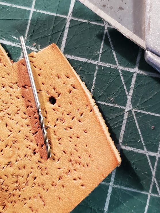

Well, I guess that the proof of the pudding and all that ....
I used a 1,5mm drill bit as a template. Unfortunately, the only scrap of thin leather that was easily accessible without going into the freezing cold garage had been used as a punch backing, hence the numerous diamond-shaped slits.
But to be honest, I don't really see the point of a 0,75mm corner radius, it is barely noticeable without a magnifying glass or close-up photo,
Clive
