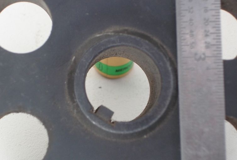

Ian S C06/05/2015 13:15:14
avatar
7468 forum posts
230 photos
Here's a gear outof my junk collection.
