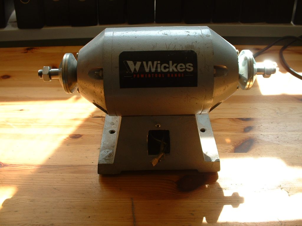

Hi. I have part of a Wickes bench grinder to hand. Motor is rated at 250W, and 2950 RPM. The spindle diameters are 12.5 mm. I would probably need a circular saw at least 160 mm in diameter. Spindle centres stand about 130 mm from bottom of the base.
Would it be suitable as the motor drive for a table saw to cut thin sheets, like wood and aluminium? Thanks.

i would not build a bench grinder using that motor, the answer is NO

I see no reason why not, a motor is a motor after all.
It looks to have decent cheek plates but they could always be replaced and the top speed is well within what a 160mm saw blade safely travels at. My main concert is whether 250W is sufficient for you needs without over loading it. Depends on what you mean by thin sheets.
I have a tiny table saw of about this power that I use for cutting laminate, alloy and thin brass sheet for the engraving machines.

That motor is one third of a horse power it will not have the power to cut

I reckon that will be a nice machine for cutting thin acrylic brass & weaker aluminium alloys. It won't be as fast as a full power table saw, but will have more grunt than some cordless 6" saws on the market at the moment. Go for it.
The only slight reservation I have is that some saw blades run at 6000 rpm -ish, so this may be a bit slow. I doubt if it'll be worth putting in gearing/belt to go faster.
Have you considered mounting it on the underside of your bench (inverted or on a pivoting angle bracket) so it's not in the way? Could then either raise it up or just have a small permanent protrusion on the top of the bench.

the 165mm cordless circ saws tend to run around 3250-3750rpm so you are not too far off and a bit slower is probably better for matal anyway.
Wattage may just be OK for thin makerial, as a comparrison a DW cordless has a 460w motor but I doubt thin brass and Ali would load it as much as say a 40mm hardwood worktop which they whizz through.
Get as thin a kerf blade as possible as this will compensate for the lower power.

A saw bench blade and spindle are put under a heavy load, my saw bench has 3 ball bearings and is belt driven from a 2HP single phase double ended spindle, the other end drives the planer table. I also say 'No' to its use.

Only if you apply a heavy load. The OP did state thin wood and light alloy and mine cuts that fine on 180W
Proxon make a very nice saw bench that must be all of one watt, don't see anyone slagging these off ?

Also bear in mind there will be no brake on it when power is cut, so even with power cut it'll run forever because of the inertia of the blade, I'd advise making sure it's got a good guard which drops when you're done cutting!

My only concern is that these do run quite hot as they don't have a cooling fan.
Try to avoid repeated starts or extended use (a bit of a 'caught both ways' there).

By the time you get a table mounted above the motor, you will have lost most of the usable depth of cut. It is preferable for the saw teeth to be cutting downwards as opposed to near horizontal when operating at a "shallow" depth of cut. As others have said, there is not much power available for that size of blade.

I did a drawing. For a 165mm dia. blade: If the blade was proud of the table by 10mm at the maximum height, at the cutting point, the teeth would be coming in at an angle of appx 30 degrees to the table. There must be something on the internet about these matters. I'm assuming cutting is on downward movement into the table.

You really want the bottom of the gullet level with the top of your work as a general rule, more so with the slight negative rake of the blade I linked to. So probably about 15mm  projection from the table for your 3mm plate.
A riving knife behind the blade to support the crown guard not only does the obvious job of protecting the blade but should the work try and lift mid cut the bolt where the guard pivots will also limit the amount of lift and save the work getting thrown up at you, the riving knife itself will also help stop the work closing onto teh blade which can happen with metal as well as wood.

I think you may be needlessly imposing a large diameter blade ...
Have a look at this design
O.K. you would need to make a spindle, but you could then use small diameter blades from the portable trimsaws.
