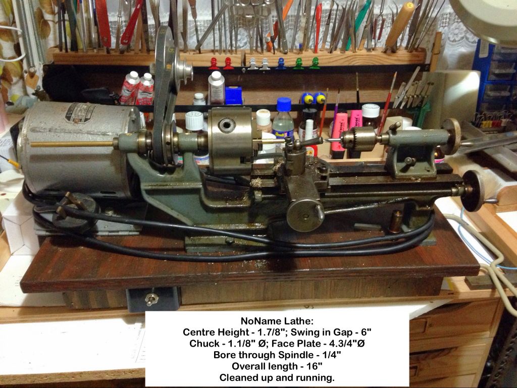

No name lathe.
No name lathe.
No name lathe.
Another machine into the Workshop from the shed.
It needs the chain oil cleaned off, as I covered it with the stuff before it went into the shed.
No name visible, but it appears well made.
The screw feed for the saddle has a RH thread, so if was case of "OH" when I twiddled the knob after oiling up surprise
There is a capacitor under the base.
Had to make a chuck key and need a set of turning tools.
Any info about it would be appreciated.

Looks very much like one of the small lathes marketed by S.Tyzack's (Zyto's etc.) after the war or one of the Adept series by Portass from just before. There were several models in those series' that all looked slightly different.
I'd hit lathes.co.uk under one of those names. Your lathe looks very much along their lines.

That toolpost looks sufficintly unusual to be a good identifying feature.
... Happy Googling

Centre height about 2 1/2"?
I bet that 4" chuck isn't original...
Working through THIS list should keep you happy for a few minutes.
The bed resembles the Flexispeed, but is obviously bigger. It may be one of Brian Perris' designs.

The bracket supporting the end of the lead-screw just short of the gap and the rather nice swivelling top slide should be diagnostic as to the maker and suggests the lathe was originally sold at a relatively high price for this style of machine.
Generally the top slide only, lead-screw shorter than the bed lathes were bottom of the range machines made a simply and cheaply as possible to be affordable by impecunious purchasers. The extra lead-screw bracket and nice top-slide on this one must have pushed up the cost somewhat. Most makers felt that full length lead-screws permitting screwcutting and / or incorporating both cross and top-slides would be more attractive to a customer able to spend a little more.

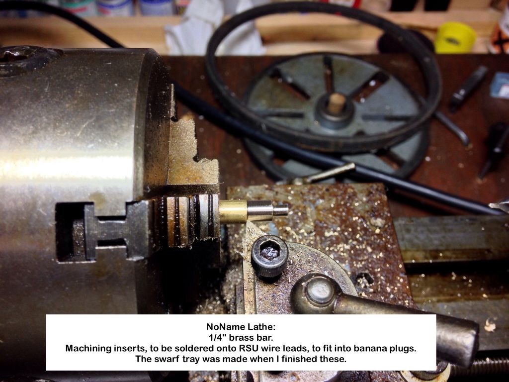

More details:
NoName lathe.
Used it for the first time last week, making brass parts for the RSU.

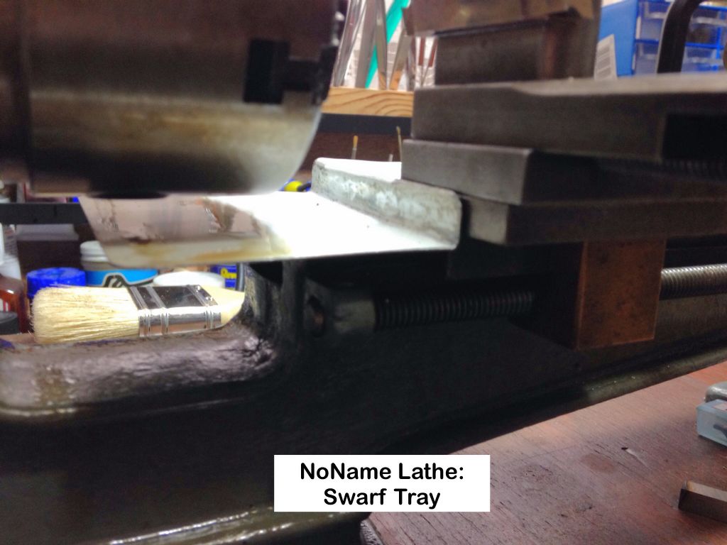

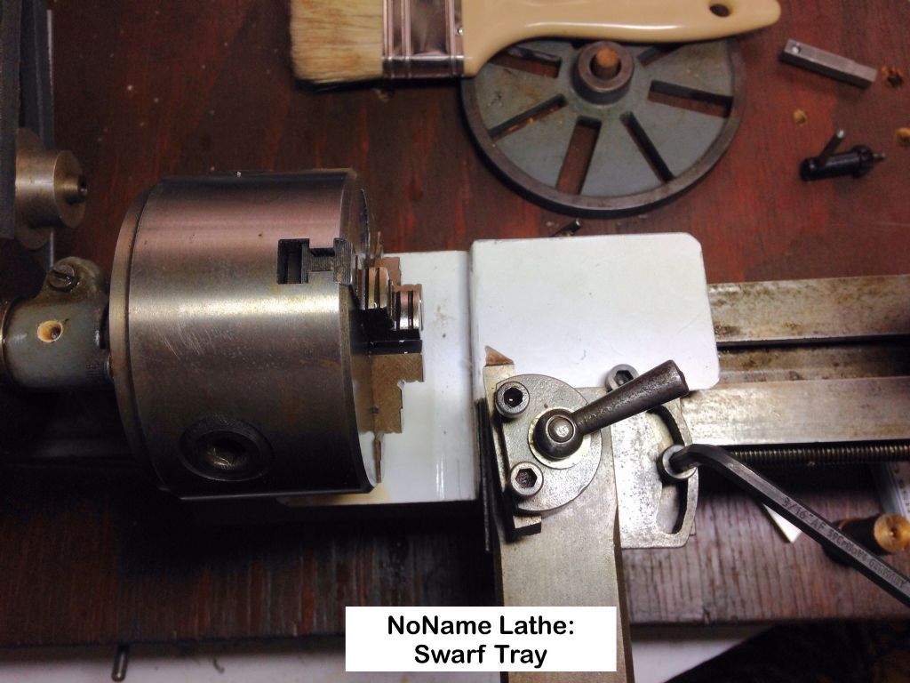

NoName lathe.
Swarf where not needed so made a suitable tray yesterday.

It looks very perris-like to me, with a dash of flexspeed and a hint of cowells
Lathes.co.uk is down at the minit, Tony must be doing some work, but that's where you need to start

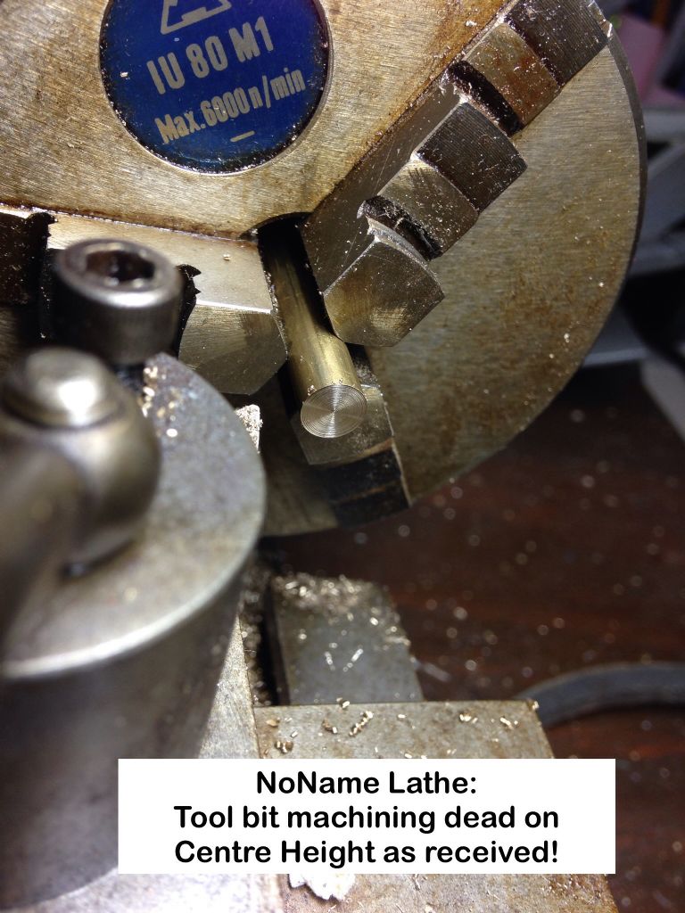

Did have a wtf moment when the centre drill just would not do as designed, and kept heading off to the right of the brass.
I checked everything, tried a larger centre drill but that did the same.
Being seated whilst machining, I couldn't see the tool bit. See where I'm going
The taper on the centre drill was coming up against said tool bit, and being deflected!
I had kept the Cross-slide at the final setting for the brass plugs, to save measuring each time.
Small has limitations.
Geoff - What a relief to find it wasn't something serious.

It's a Flexspeed.
www.lathes.co.uk/flexy/index.html
