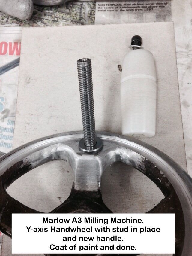

Time to sort out the Y-axis Handwheel.
Advise please on how to reconstruct the handle boss.
Handle with boss went AOL during delivery, never to be found.
I have some of those all singing & dancing aluminium welding rods, but haven't tried them out.
The paint on the wheel will suffer, but I can live with that as the machine is intended to work as designed. Been using it of late and it's nice & solid.
Top photo shows the wheel with boss missing, whilst the second shows the X-axis wheel complete.
Making a new revolving handle is not a problem.

JB Weld would be of use here. Patch up the old area. Might want to use masking tape to cover one side as best you can to hold the JB back. Probably have to build it up in layers to keep it from running out too much. Trim it with rasps and files just before it fully sets. Then when that's done, move to a different spoke and mill it out to suit, drill and tap to fit the new handle. I think you have enough metal on the rim to dispense with the boss. An Option. Good Luck with whatever you opt to do.

Geoff, from the photo the rim looks thick enough to spot face an area at one of the other spokes and put a handle
in there. As for the damaged bit ... body filler ??
There are a few metal casters on here who might use your X wheel as a pattern and make you one.

The best way would be to clean up the area by plunging in an end mill of the correct diameter to create a circular hole. Then machine up a boss the same diameter as the end mill but a close fit in the hole. Drill and thread the centre to match the male spigot on the handle then use your magic aluminium welding rods to weld the boss to the hand wheel. The secret of the welding rods is a) clean all the paint from around the weld b) make a angled prep around the weld area c) puddle the weld at the joint and use the stainless scratch rod through the puddle to scratch away the oxide on the parent metal beneath the puddle. It works very well and gives a strong joint.

I can guarantee if they are the same as mine they are cast aluminium, personally I would get it TIG welded failing that I would replace the handle either buying a new one or make one from solid or even cast one using the other axis as a pattern.
Or you could just move the handle position to the other side and fill the original hole with JB weld, stepped stud springs to mind so the hole in the wheel is kept small

Possibly worth laying a piece of copper or stainless round bar in the remains of the threaded hole to prevent it getting filled up, if thinking of using TIG. Could be pretty challenging trying to fill such a massive void without anything to contain the filler. That way you'd have something to work around.

The consensus appears to be leaning towards the TIG solution.
Geoff - GD told me to "shudup" after telling her to do so whilst I was using the Marlow surprise smiley

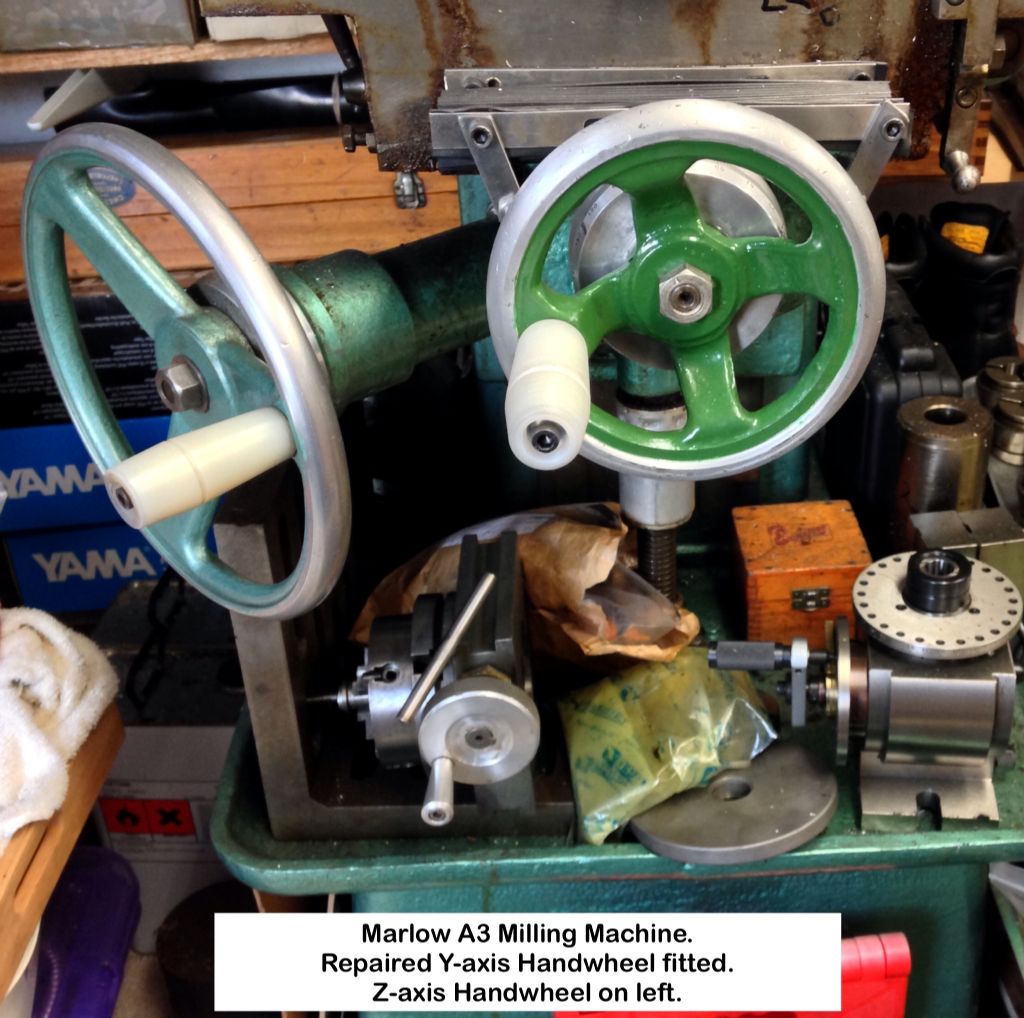

OuBallie15/03/2015 04:40:54
avatar
1181 forum posts
669 photos
Repaired by JS, painted and plastic handle by Your's Truly, and now back on the machine.

Ian S C15/03/2015 09:06:23
avatar
7468 forum posts
230 photos
Geoff, now you'll have to paint the other hand wheel. The repaired one looks good.

OuBallie15/03/2015 10:18:54
avatar
1181 forum posts
669 photos
Ian,
Ta for the compliment, but without JS' absolutely perfect repair, it most certainly would not look like it does.
Very pleased with it, and now useful.
