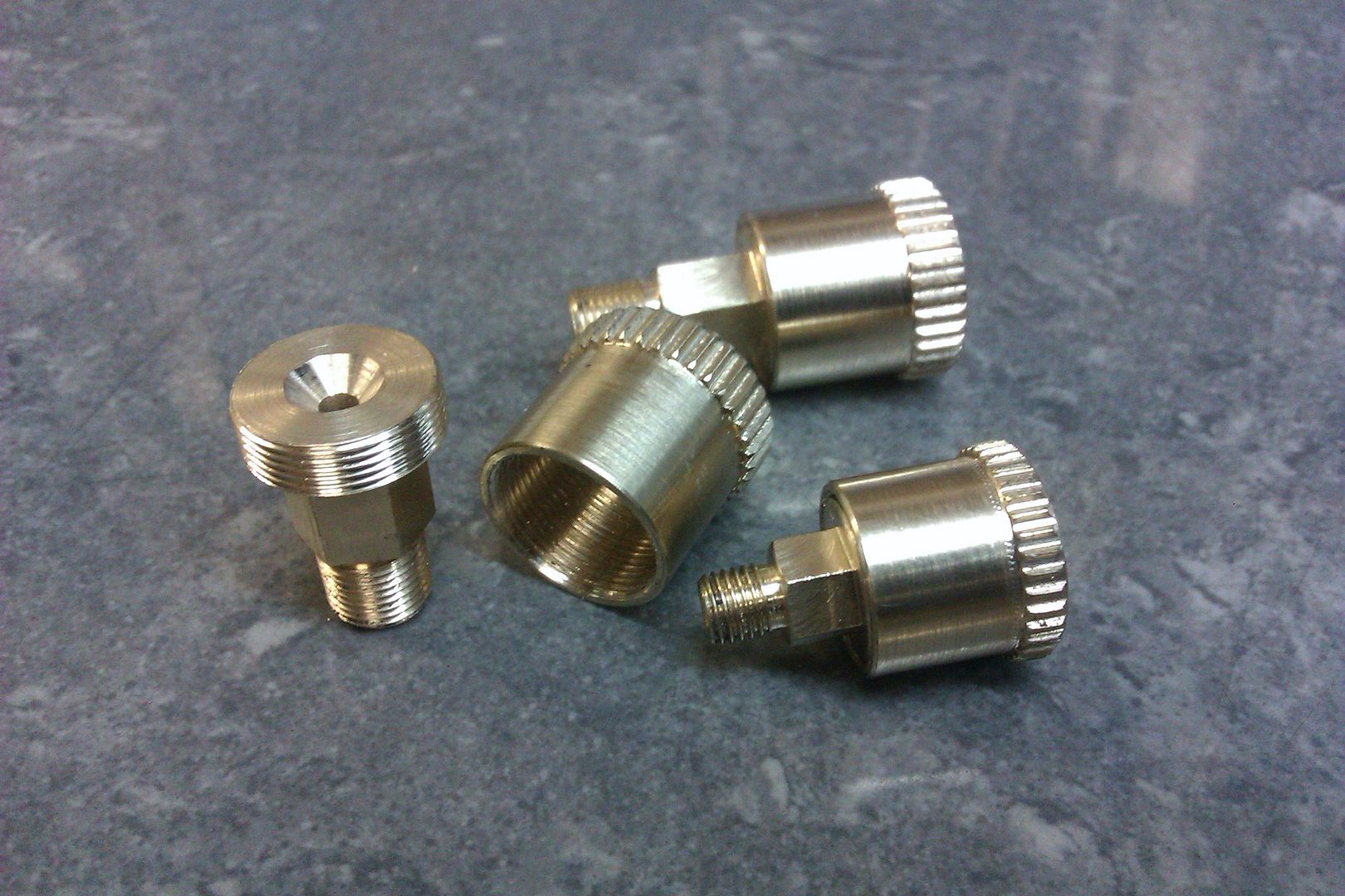

These are a few things I have done in brass since christmas all done with dies and a tailstock holder, run on under power @ 50rpm while holdinmg the dieholder.
These have 3/16, 1/4, 7/16 and 1/2 X 40, threads are tight a sthey are greasers and I don't want teh grease finding its way out the thread.
And these have 3/16, 1/4, 5/16 and 7/16 x 40
