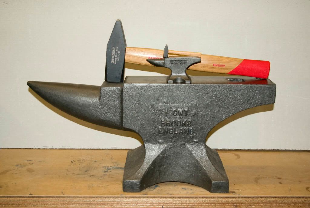

I've fancied having a go at some basic 'smithing' for a while although my experience totals making one horseshoe at college 41years ago.
Anyway I was int'pub with local part time dellboy and scrappy when he said he'd seen an anvil someone wanted £100 for and I jumped at that subject to it being in reasonable condition and full size.
It turned up yesterday and the top is pretty darned good , the horn has a little asymmetrical wear. It has the usual square hole but also 2 round holes of different sizes all at the opposite end from the horn. It also has a side 'shelf' jutting out on the side of the main body towards the horn end (facing the shelf the horn is to the left).
It's certainly heavy..probably 2cwt or so but no name etc anywhere. I can lift one end and walk it sideways Picking it up is not an option with 2 of us.
It's in the hobby shed now and I'm startng to clean it up.. wire brushng off some algae stain etc.
It's been painted? black all over. Anyone know if this is likely original (as it looks) and what sort of paint or stove blacking might have been used - or should it just be redone with hammerite? There's a few small flakes of coating where superficial rust shows through but I plan to keep it outdoors under a covered area for when i build a forge so full coating is necessary.

Don't worry about rust on an anvil. Once you start using it the work will soon clear off any rust on the important bits.
A bit of rust on a good anvil will not affect its' value or usability at all. If you feel you must have a finish on it, I recommend stove blacking. It won't attract dust and fibres like oil or grease would, and is not flammable.

The best old ones have a wrought iron forged base and the upper surfaces are faced with tool steel (usually tool steel by crucible process - very expensive at the time, small batches of a few pounds/kg's each, made in a crucible).
Newer ones have nodular cast iron bases and are faced with AISI 41xx or 43xx series tool steel. The high quality very expensive new ones (mostly made in eastern Europe now) are still made with forged steel bases.
Both old and new, if made well, have the tool steel facings fire/forge welded to the base. To do this both pieces are brought to white heat and are hammered or power forged together. JD
PS the cheap painted cast iron small anvils from China, as sold by the DIY home centres and hardware stores, are rubbish. No steel facings on the top. Iron very low quality cast. One good whack from a real smith doing real work and they shatter. About all they are good for is straightening soft wire and sheetmetal. Try and forge a 1" square bar and they go to pieces.

Thanks for the comments. Since it's going to live outside and in reality won't get used often, I'll go with the stove blacking and make it nice.
I've got to come up with a stand for it. My chainsaw ability doesnt ever get two parallel cuts on any log of the required diameter and facing the ends with a router I have done on making a coffee table out of a 4" slice that diameter but the jig making for a 2 foot high job wouldn't be worth the effort so I'll likely go with welding up a stand. I did come across an interesting simple idea of using a cut off oil drum filled with tamped sand & ballast but it'd end up sitting in the damp.
Hopefully scrappy can turn up some economic recyclable stock. He's also on the lookout for a large brake drum for my forge.

Unless all you are doing is making horseshoes you should try to keep the working surfaces rust free as any pits and dents will be imprinted on the work.

Do not mount the anvil on a steel stand, mine is just fixed to the end of a suitable log, indoors will last years.

If you're going to spend a good bit of time at the anvil, set it on the end of a 16-24" diameter oak log buried 2 to 4 feet into the earth. The top face of your anvil should be 2 to 4" or so below your elbow measured standing next to the anvil with your forearm straight horizontal. The anvil should be no more than 2 1/2 feet from the forge.
Steel barrels and steel stands are not good for anvils, they spring back too much. Solid wood, endgrain vertical is the best material for supporting an anvil.
Forgot to mention that the round and square holes you have in the rear face of the anvil are for hardies and swages, which are various chisel and concave shaped tools used to cut, punch and shape the iron.
Charcoal (lump not briquet) is an excellent heat source for your forge if you can't find bituminous forge coal or metallurgical coke nearby.

I was looking at the larger log options whilst splitting firewood today. I'm not sure any was left thick enough for this job..specially since I'm over 2 metres tall and I don't fancy a narrow top heavy base. I might get creative with a stack and brown foamy glue since it occurs to me that rotating 2-3 slices could end up with a level top - but no rush until the forge is made and a carport like cover.
Meanwhile I'll finish cleaning it up and stove blacking.
Oh, and it;s also got a horizontal square hole up it's back end...
